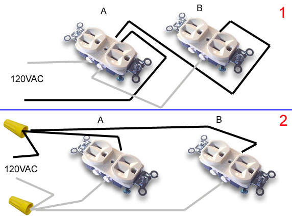

I can not understand what is happening here. I have this unit
Based on this picture:
I plug in a motor which is pulling 6 Amps in plug A, I plug in the EMI filter (link from above) in plug B.
When my plugs are connected like in #1, EMI filter drops the the Amps down to 3
When my plugs are connected like in #2, EMI filter has no affect.
For both #1 and #2 plugs are 6 inches apart and wires are 18 inches long.
I am clueless!
Mike
The sockets should be wired as in B. The device you have bought appears to be another con. It correct the power factor and so will reduce the current into your house. It will not however reduce your power bill as you only pay for power that is used. Sorry.
Wow, just noticed the price, $200, what a con.

Sorry my drawing is not very clear, both #1 and #2 are connected in parallel, each set of screws on the plugs have not been separated and that is why I don't understand what is happening. Look at this video (you can skip to 3:14) I get the same results but I can't explain why and on top of that, I get different results based on how I connect.

Assuming that the link tabs on each side of the socket in picture #1 have not been broken off, then electrically there is no difference between 1 and 2 and I can't see why you would be seeing a difference in motor current consumption. However, Pommie is correct that the wiring should be as in #2 for safety reasons, code compliance, and to follow industry standards (which is important in house wiring).

After some thought, I decided to approach this like Sherlock Holmes. Principles of electricity tell me that there should be no difference in your current reading whether plugs are wired as in #1 or #2, so I deduce that the plugs are not wired as in #1 or #2.
ok so let me give you the complete story. I didn't buy the EMI filter, I borrowed it to make some tests because I was skeptical about this unit so I built a small test box by wiring a voltmeter, ammeter and its shunt as indicated in the previous links, a regular home wall switch and 2 plugs and I connected the plugs as in my drawing (#2) I had the AC supply feeding the switch and then the shunt and then a small power supply I made to provide 12 volts to voltmeter and ammeter.
From the above configuration I plugged the EMI filter in plug B and a motor in plug A, turned on the switch, motor came on, ammeter showed 6A, turned on EMI filter and nothing changed, still reading 6A. (double checked with my clamp-on meeter to confirm) and made sure I have 120V in plug B.
I then connected the wires like in #1, did the same test and when I turned on EMI filter the ammeter dropped to 3A.
