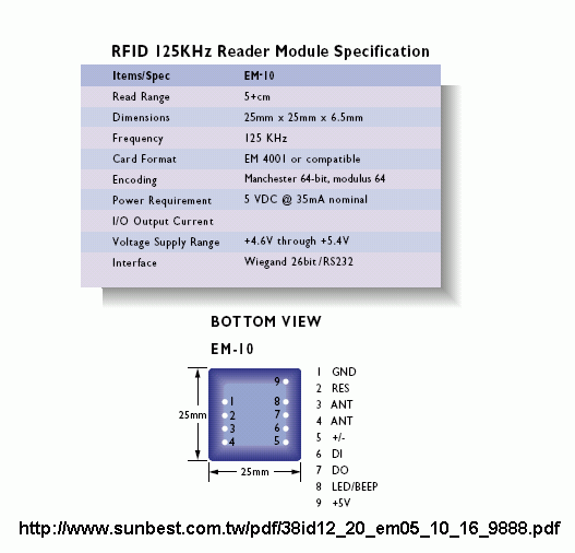

Hi all people,
This IC is Radio Frequency Identification Device which is 125KHz operating IC. It is a sequel IC to ID10. I want to connect it to microcontroller.It has serial o/p @ 9600bps. I need a datasheet for it as I have abv info only. Conn.Params required.

Wow hard one here is the best I could do for now.
Ya ,thanks a lot, I worked out on it and found it useful too.
But my problem now is that I can find the IC working but not @ 9600bps. At 4800bps i get some garbage displayed in Hyperterminal program. I was told that EM10 is pin 2 pin compatible with ID10. I tested out with multiple testpoints but cant find out whats wrong.
