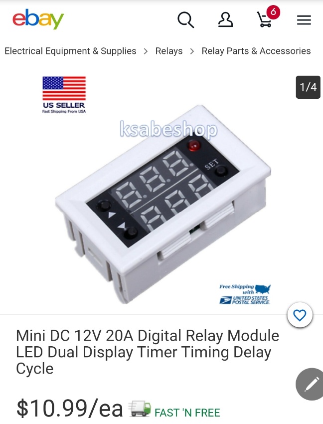

There are a variety of timer modules available on ebay.
This is one of the "more finished" versions. Others are a pcb with a 7-segment LED display.

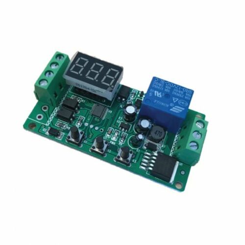

Ive searched the web for something off the shelf and there are plenty of cheap boards that have everything I need built in. The problem is thought the displays are always attached to the boards or the displays have buttons for programming times which is not what I want.

This little fella would do the job but the LCD isn't detachable.
How far away from the PCB does the LED display need to be ? Would it not be possible to unsolder the display and extend it to where you require it ? As it is probably a multiplexed display there would probable need to be 10 or 11 wires (Depending on if the decimal point was used.) Is this a one off machine or a large production run ?
