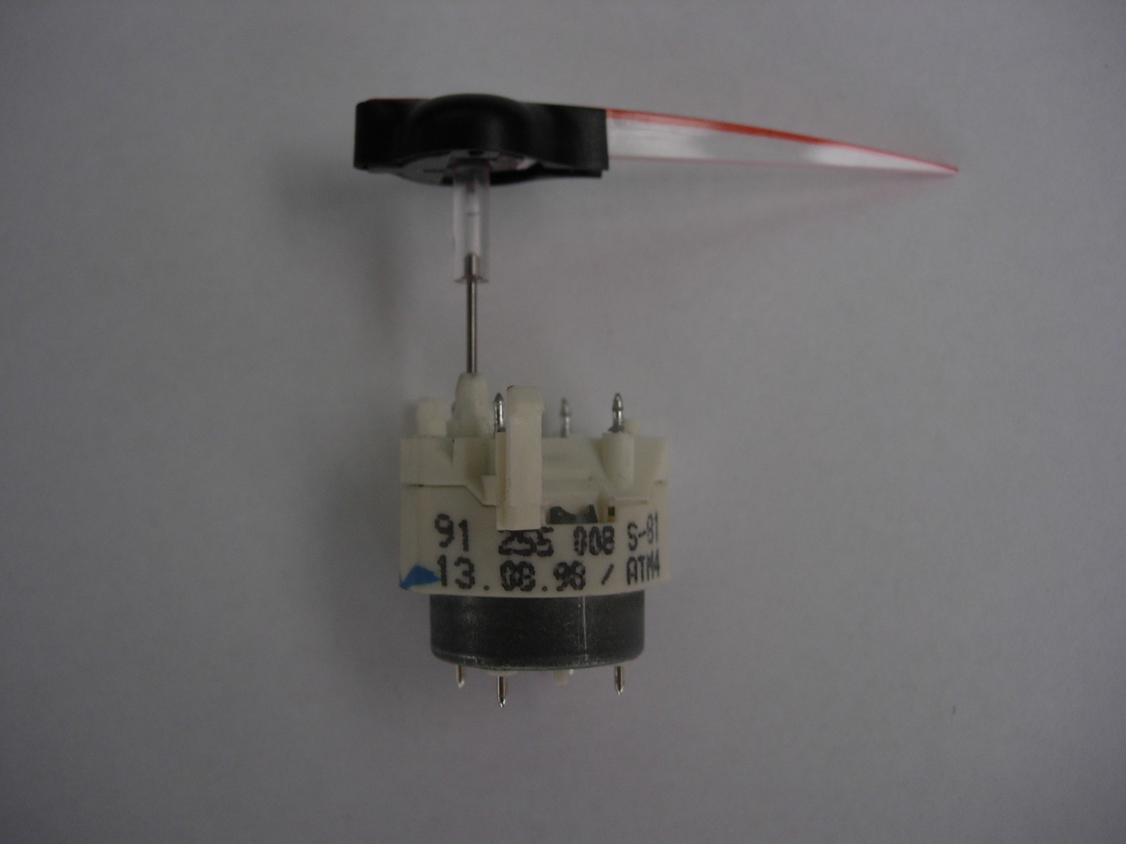

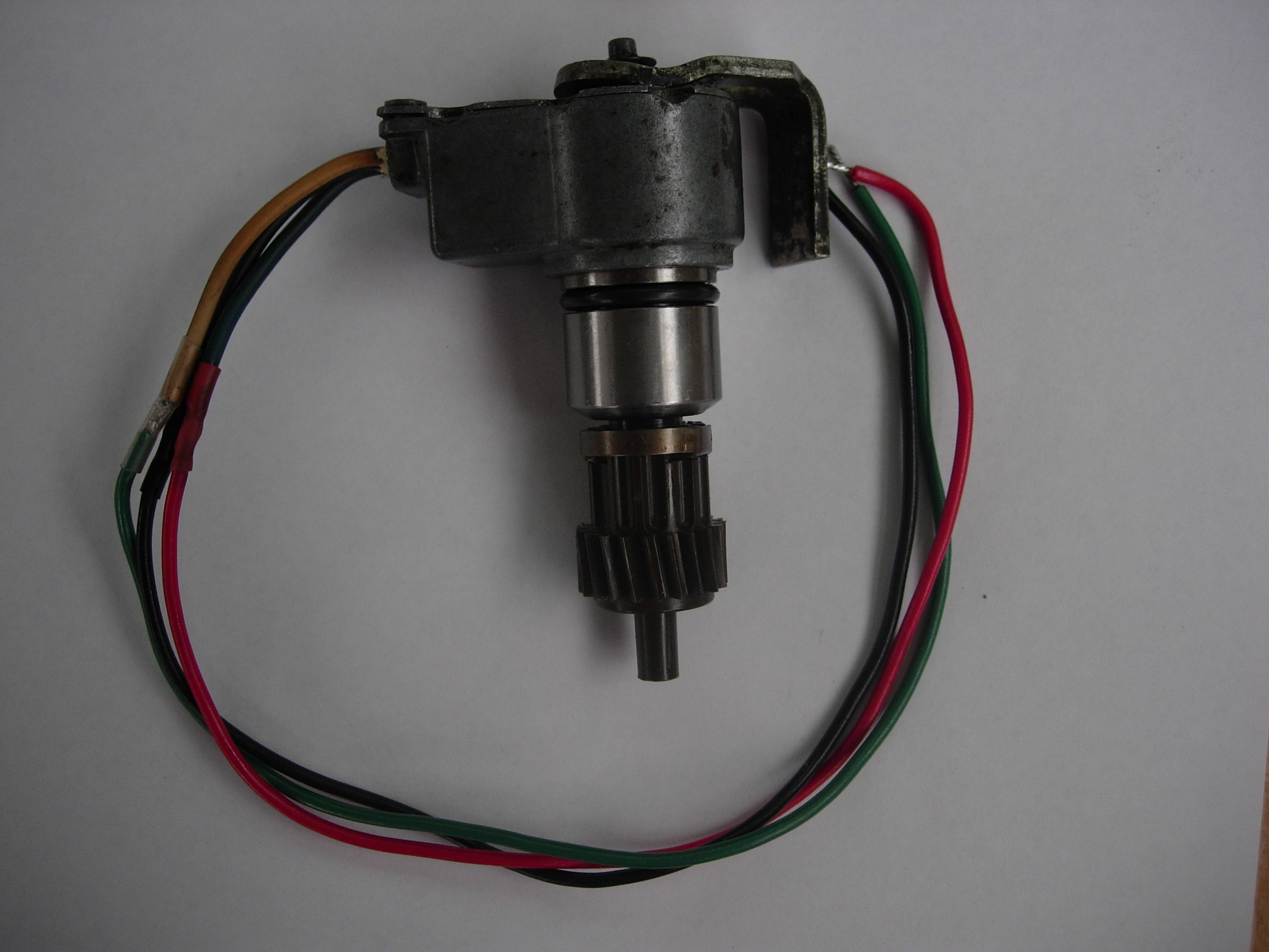

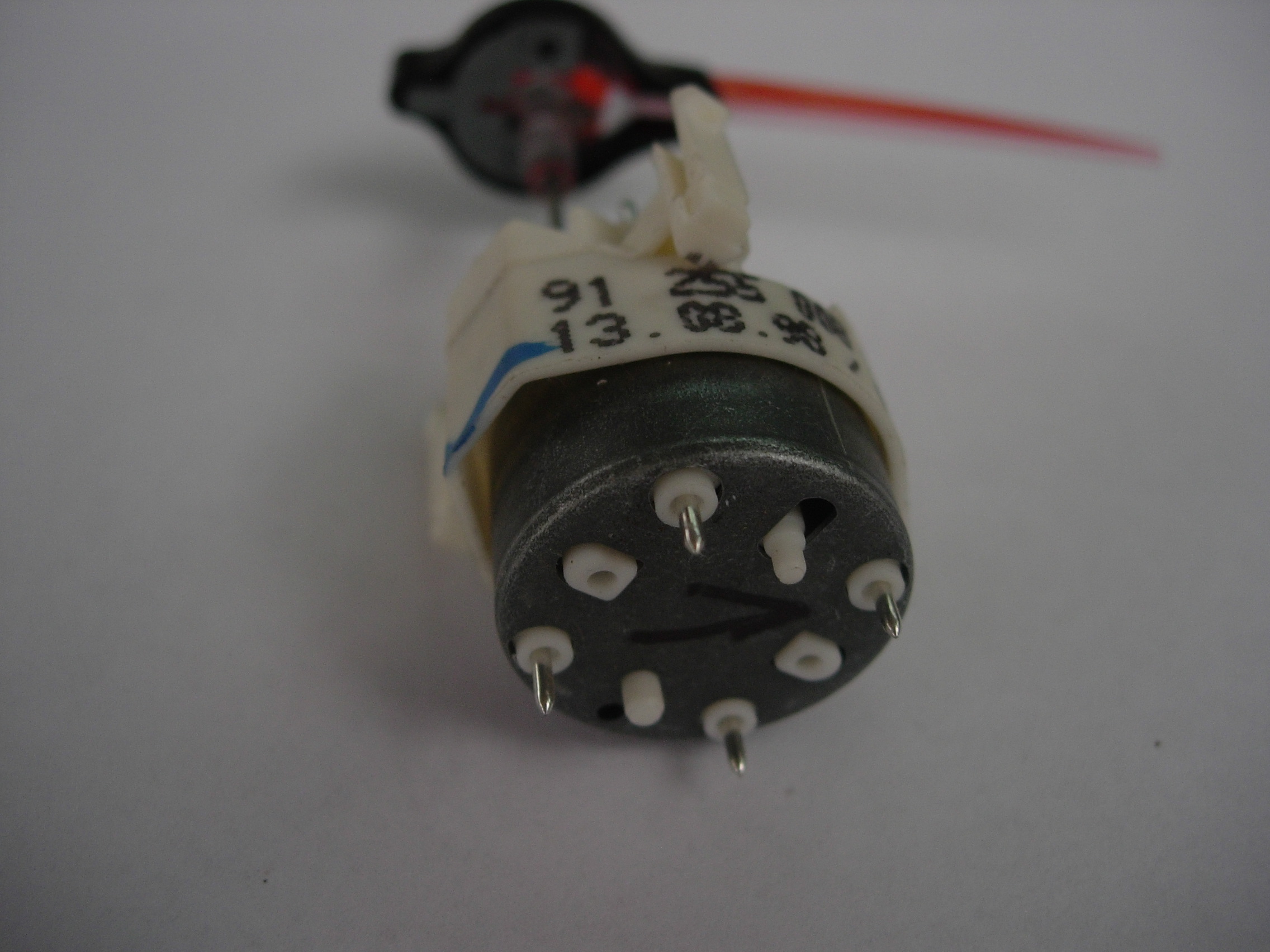

This is a stepper motor from a Ford instrument panel & its made by VDO. It used a custom VDO processor to drive it. The instrument panel was driven by the speed sensor on the transmission. It uses a Hall sensor to give a square wave output.

Thanks for all your help. I think VDO data sheet debe showed is what I need. I,ll check out the other links also. Being a retired mechanical engineer gives me a lot of time to tinker and learn how to do new things.
Thanks again, Dave
