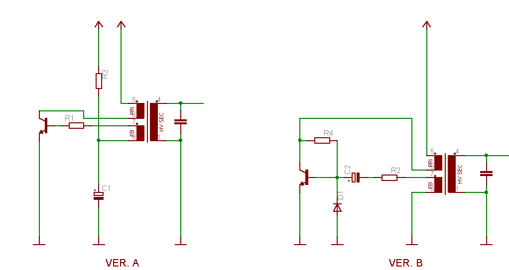

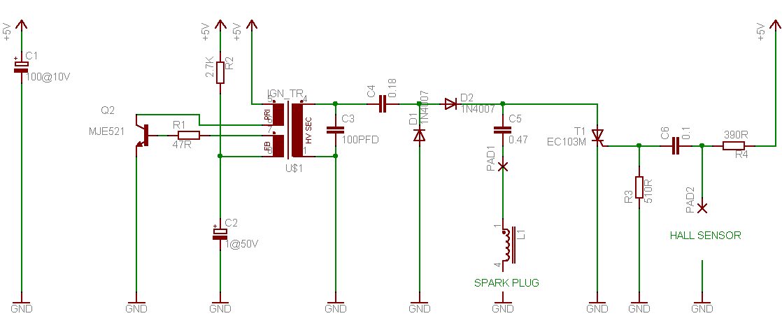

I would suggest using a simple CDI ignition as is used in model airplanes and boats. This link is a DIY version. This is a forum devoted to that version. You do not need a microcontroller to just get sparks.

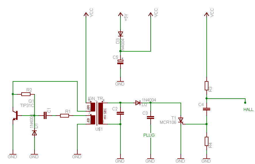

In case you are adventuresome, here are reverse engineered circuits from a Chinese (left) and American (right) commercial CDI units.
Most people stumble on making the transformer. For single sparks as one would use in a spud gun, a transformer from an electronic flyswatter, CCFL, or similar will work. You will not need the hall switch. A simple push button will work. Finally, be aware that all of these circuits may give a spark when first turned on. be sure, therefore, to have the circuit turned on before loading your spud gun, or you may get a surprise.
