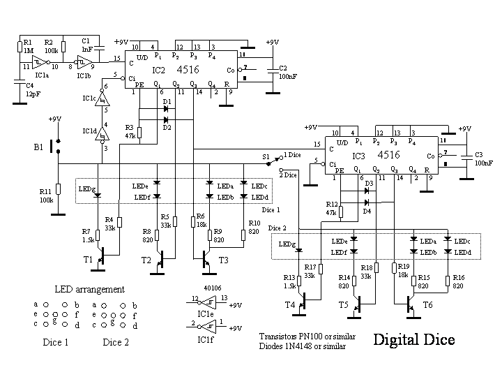

i want to ask anybody out there that know about electronic dice design by using PIC,FLIP FLOP or DECODER that use two dice in one time.when the switch is pressed the dice will obtain 2 different number (random).sorry to say that i'm not a good designer.
No need to use flip flops or pics. All u need are counters, decoders and oscillators. With the proper configuration those will do the trick.
Here is one I designed & built some time ago.
