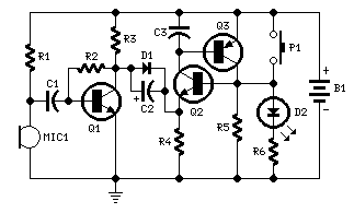

hello,
Pls. help me with the circuit flow of this diagram.
when switch S1 is depressed it shorts the supply voltage to the base of Q2, turning Q2 on. The collector of Q2 starts to pass current, charging up C3. This pulls the base of Q3 low, thus providing voltage to the base of Q2, so when the switch is unpressed, Q3 keeps Q2 on. This is a transistor latch circuit.
When an audio input comes along, the collector of Q1 wiggles, this puts a voltage on the emitter of Q2, reverse biassing the base-emitter junction of Q2, switching it off, so the light goes out
Simon
Puff to off led
Help me plss.
how does the circuit works. Why does the led wont turn on when the switch is off does the current wont flow from the collector of transistor 3 to the led ?
PLS. THANK YOU! I REALLY NEED THIS BADLY!!! :cool:

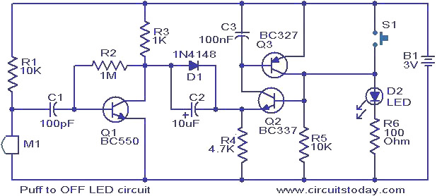

Thank you simon,
but is the led would still turns on without the latching transistor? (separate question) and when the switch is unpressed does the current flows through the led? why does it wont on? Is the entire circuit divided by a bridge? the dioed and the capacitor in parallel? thank you

I have seen this one before and I found the circuit in Google. It looks like it is from the website of www.redcircuits.com but it is not there anymore.
The first transistor is an audio preamplifier for the electret mic and the 2nd and 3rd transistors are connected like a PUT (programmable unijunction transistor) that can latch on when the switch is momentarily turned on then the preamp can turn it off.

The website explanation for the attached circuit:
Description:
This is a simple circuit in which the glowing LED can be switched OFF just by a puff. A condenser mic (M1) is used to sense your puff. When the push button S1 is pressed, the transistors Q2 and Q3 wired as latching pair gets activated and drives the LED to glow. The LED remains in this condition. When you puff on the condenser mic, the sound pressure is converted into a voltage signal at its output. This voltage signal will be amplified by the transistor Q1.Since the collector of the Q1 is coupled to the emitter of the latching pair, the pair will stop conducting when ever there is a signal from the condenser mic due to puffing and the LED will go OFF. The push button switch S1 has to be pressed again to switch the LED ON.
The circuit works as AudioGuru explained and as covered in the quote. To understand the circuit description you need to understand how the individual components work. You need to start at the beginning. You don't learn to swim by jumping into the deep end of the swimming pool. If I tell you that Q2 and Q3 form a latching circuit and you do not know what a latching circuit is or how it works we got nothing.

The circuit by Circuitstoday.com does not work. As can be expected. None of their circuits work.
Here is the corrected circuit:
The main problem is the 100p on the base of the first transistor.
It should be 100n. The diode can be removed to give a slightly better effect.
It should be 100n.
The original circuit is still at www.redcircuits.com/Page122.htm and C1 is also 100pf.
A "puff" is high audio frequencies not the low frequency vowels of speech.
The electret mic with the 10k resistor powering it is about 3k ohms and the input resistance of the very high gain "C" version transistor is about 5k ohms. Then the cutoff frequency of the 100pf capacitor with the 8k load is too high at 200kHz. Maybe C1 should be 2nF for a cutoff frequency of 10kHz.
thanks to each and everyone who helped. Actually McFly is my classmate and before i was been registered to this site which he already does i asked him if he could post my project so anyone could help me because its not working and he did but later on i did register to this site and posted it again because i cant regularly see the comments because its not my account.
Thanks to everyone who helped I appreciate it, now i know why its not working its a bad circuit. I already replaced my project I should have consult it here before buying it T_T. MANY THANKS..
I e-mailed Red Circuits and informed them that the circuit has the problem with the audio coupling capacitor value that is much too low so it passes radio frequencies but does not pass audio frequencies.
Flavio at Red circuits replied and said that he tested his circuit and it works perfectly when blowing on the mic which is big (5mm diameter) and therefore it is sensitive at a distance of 10cm.
He noted that his first transistor is spec'd to be a BC550C that has a current gain of 420 to 800 and not as low as 110 for an ordinary BC550 or BC547 so it has a higher input impedance.
