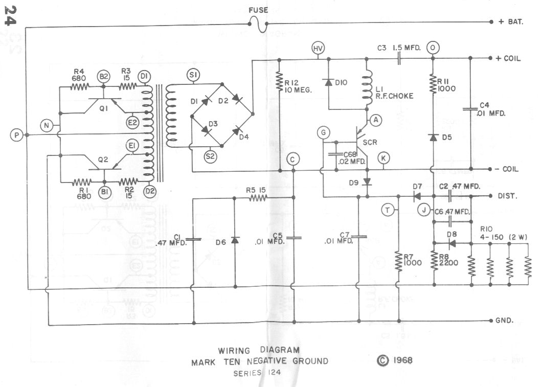

The saturation is part of the oscillation cycle. As soon as the core saturates, the driving transistor turns off. It's been done before in photographic Xenon flash units and... remember the old Mark 10 capacitive discharge ignition? See:
Sorry to post as this is out of my league, but caught my eye, as I need more Theory work to understand everything I am learning. I am a hobbyist so take it easy on me..lol
The example given the Xenon flash, sounds allot like a Florecent starter. Right at saturation it disconnects the current there-by causing the feild to breakdown. Is the math involved based on Maxwell's equations?
Am I close on my assumptions?
The math escapes me, sorry to admit.
-BaC
That's correct. The rule comes from Faraday's and Lenz's Laws. Faraday's Law says if a voltage on a wire loop varies in time: then so will the flux through that wire loop. And vice versa.
Lenz's Law states if a field expands or breaks down, a new current will appear and oppose the change in flux. This current moves in the opposite direction from the one that energized the coil in the first place. That's why you have to put reverse-protection diodes on relays.
Take a generator for example. Turning it produces a voltage to power your stuff. But at the same time, you are changing the flux and introducing the opposition current, which in turn opposes your attempts to change the flux (in a recursive relationship). If the generator is not connected to anything, the opposition current can't flow and the generator is easy to turn. But if you short the generator with a wire, the opposition current can flow strongly and the generator gets harder to rotate. Electric motors do it too. If you want to stop a motor fast, you short its terminals.
