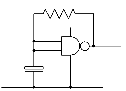

I have a homemade desktop swing, with a small permanent magnet on the swing. I want to keep it swinging when pulsed by a hidden electromagnet circuit underneath, so it keeps moving with no apparent help. The swing pulse needed is about 1Hz, which I need to adjust slightly to fit with the natural resonance. I have seen some ideas about an electromagnetic clock pendulum, but don't need this sort of accuracy. The power supply would be an AA cell (or two). Has anyone made something similar or know of a simple circuit?
The toys that work like that use the voltage generated by the magnet and the coil to trigger the power pulse to the coil.
You could try that, or you can use and RC timer. I prefer to use a 74HC132 as it only needs a resistor and a capacitor to oscillate. You will probably want a short pulse and you can put a diode in parallel with the resistor to get a very small duty cycle.

Have you gt a simple schematic of this? Seems very economical. I had thought of a 555 as a monostable giving a short pulse, but needs more components than your fast CMOS idea.

Here is the oscillator circuit that will work with a schmitt nand such as the 74HC132. The mark-space ratio is about 50% and you can swing that by adding a diode with a resistor in series, in parallel with the resistor.
A 555 needs a minimum supply voltage of 4.5V (a run down 6V battery) and has a typical idle current of 3mA. AA alkaline cells would be dead in 1 month if the circuit didn't do anything.
A 74HC132 has a minimum supply voltage of 2V (two run down alkaline cells), has a typical idle current of zero and an operating current of 100uA.
AA alkaline cells will last 2.5 years if the circuit did nothing except power the Cmos oscillator.
HCMOS gates tend to use a lot of power when switching, and that includes when the input voltages are near the middle. It is not as bad for schmitt gates, but the current could be quite a lot in the oscillator circuit that I suggested. I have never used them in battery powered circuits where long life was needed.
But using a non-CMOS 555 would be silly. An LMC555 will operate down to 1.5V at 50uA supply current typical, both less than the aforementioned 74HC132.
Yes, but with a 1.5V supply its typical output high current is a whopping 0.25mA. Even with a supply voltage of 5V its output high current is only 2mA.
I don't use both inputs of a two-inputs gate to make an oscillator because the 2nd input is just adding to the supply current.
