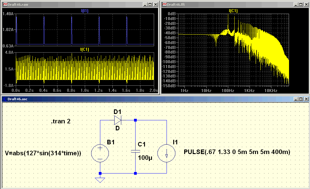

Simulation shows the low frequency component of the cap ripple current is negligible. Ripple is dominated by components at mains frequency and harmonics thereof.
The sim below uses an assumed pump current profile (I1), a worst-case scenario of 90V AC supply, and an assumed ideal inverter efficiency of 100%. Thus a 2.5A load current at 24V DC equates to a 0.666A RMS current draw at 90V RMS AC.

The SIM pump model is flawed
No doubt, but even major changes to the model make little difference to the low frequency component of the cap ripple.
