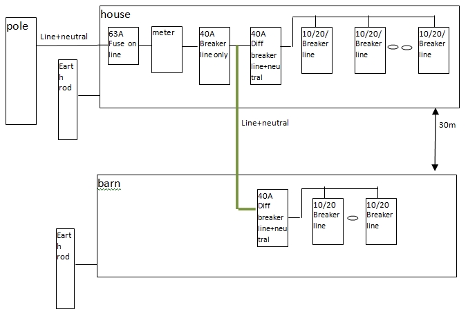

Hello again, Attached here a schematic drawing of what I intend to do. Just as a reminder, 230V, single phase, 40A contract.
I know that regulation matter and yet, proper design prevail to my very modest opinion so please tell if you see an issue

Ignoring any unknown regulations, I would still say use thicker cable - or run two pieces of 2.5mm to give you double the capacity, and a 100m drum would give you some left over for 'extras'.

looking at your schematic, you are taking the barn supply from the 40A line breaker - so the cable to the barn must be sized to handle the max continuous current the 40A breaker can supply (if it's an en60898 breaker thats about 46A) so you need 10mm2 - might get away with 6mm2.
If you're using 2.5mm2 i suggest you protect the cable with a 20A line breaker or less.
I cannot advise on Israel regs or on what makes for effective earthing there. I would think a local earth rod at the barn would be sensible - if the barn is the steel frame type then earthing the steels is probably required (it is here (uk)) and they usually make good earth rods where they bolt into the foundations.
Generally, you don't break neutral.

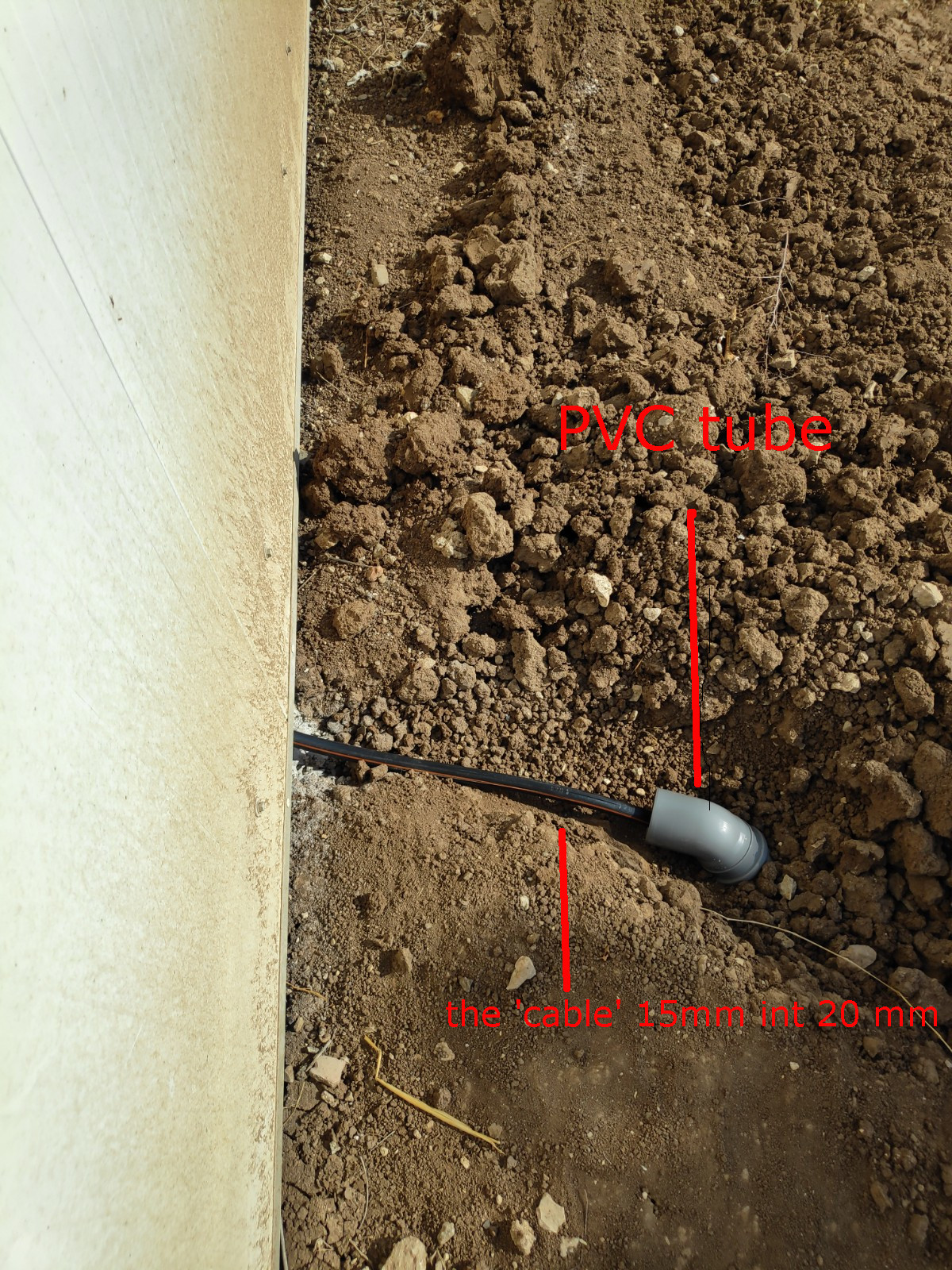

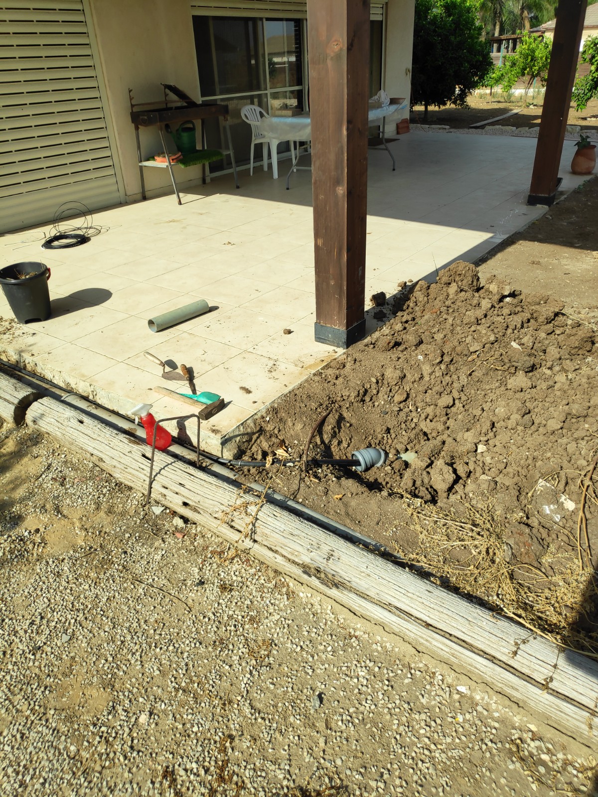

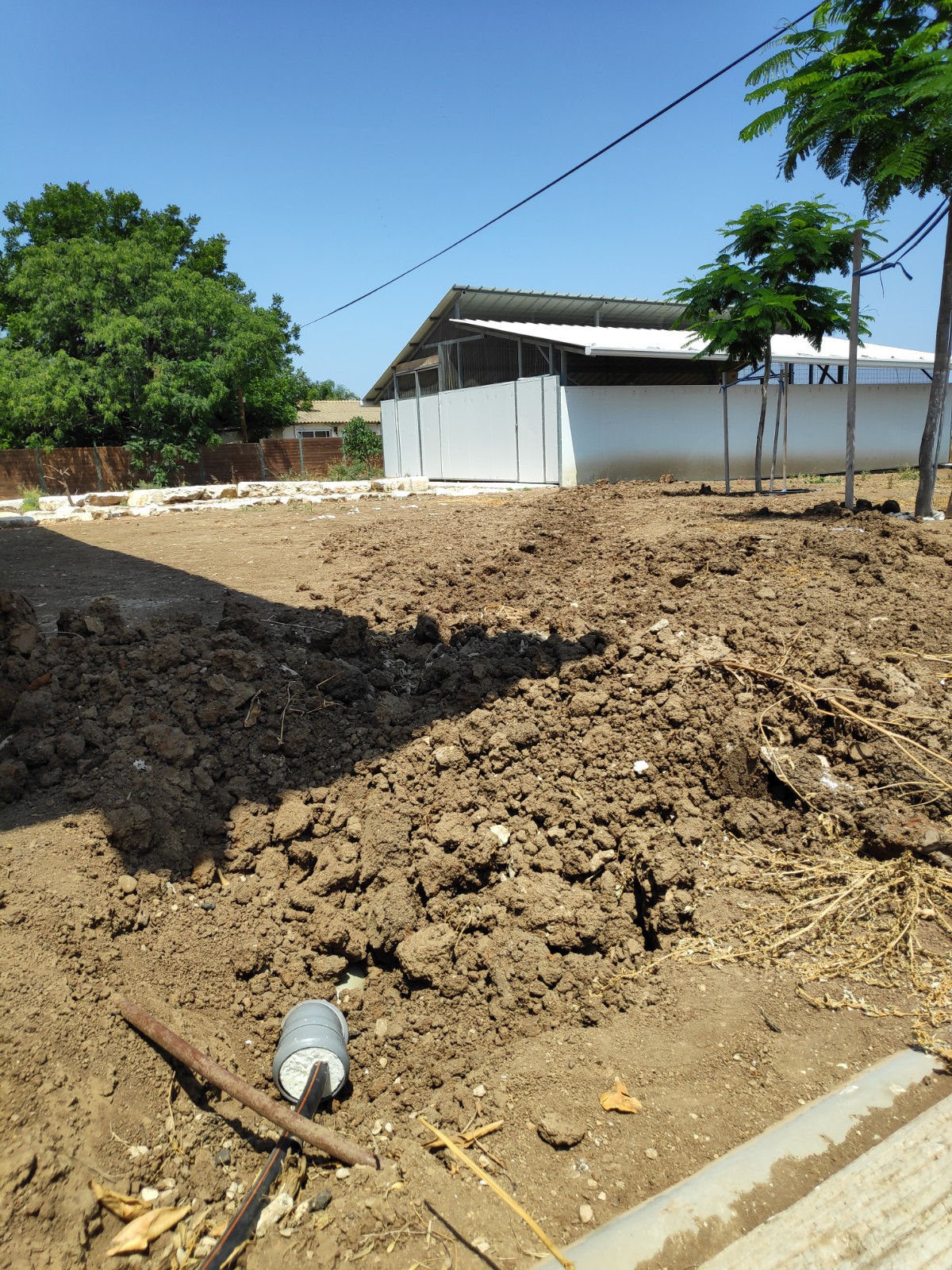

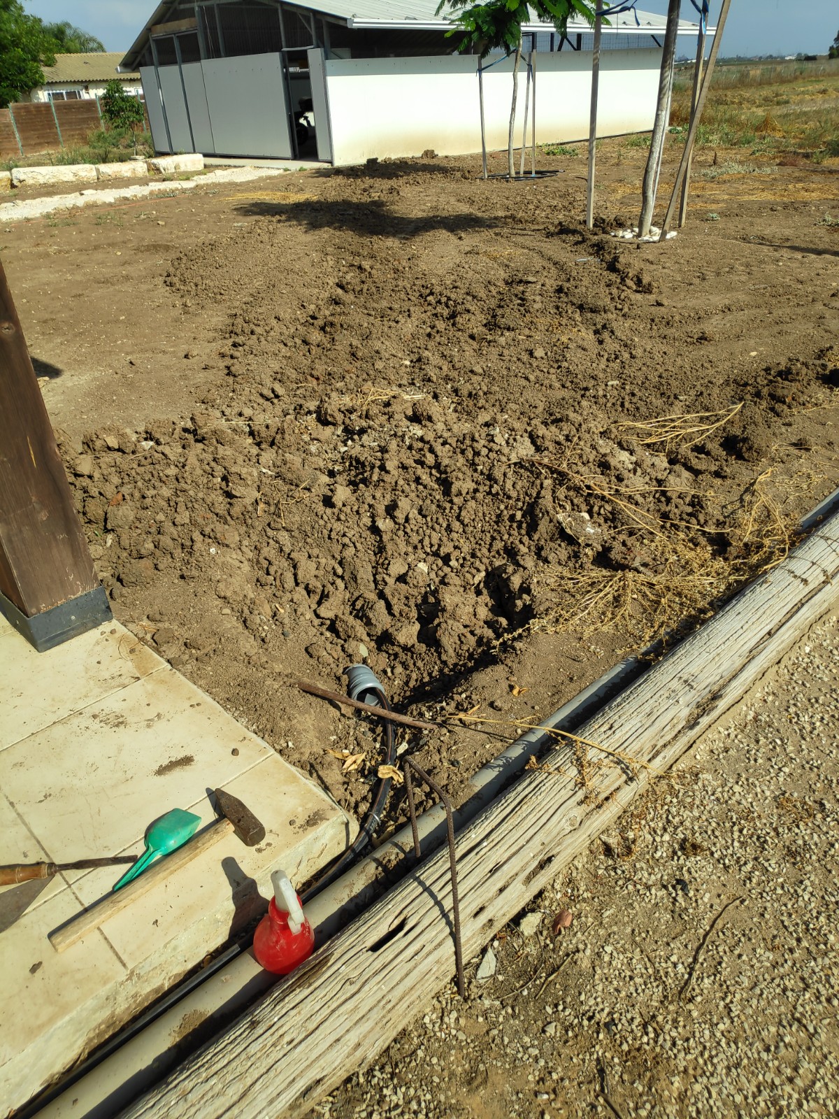

Few pics of the work. The cable -15mm internal diameter sleeve- runs in a PVC tube, in the ditch and then, unseen along the pétanque so that intruders won't find it easily. In the sleeve 2x2.5mm2 wires that should do, considering my residual life expectancy, also a 4 pairs ftp ethernet cable and a 4 pair phone cable for inter arduino serial (uart) communication, using differential transceivers - suggestion are welcome. The enet will run from the barn's arduino enet shield, through a switch, to the home's router modem. Per mab2 suggestion, i'll have 20A breaker so that in case if a 'clean' overload, equal and opposite current overload, I won't risk to melt the wires nor run home to re-establish the juice

no, the pvc tube helps prevent rodent from chewing the cable and get accidentally electrified. Also, it'll facilitate future upgrade if I happen to leave too long
Am I reading those pictures as, the "The PVC tube will fill with water"?
Probably so, but that's no reason not to do it - you can't just bury mains cables in the ground, unless you use armoured cable (as you should really) - but a MUCH cheaper alternative is to place it in piping (even in hose piping) to give it a lesser degree of protection, but still FAR better than nothing.
If you can use a decent size pipe, it also gives you the option of replacing the cable by 'pulling it through', or even adding extra cables at a later date.
If you've got a digger, and a supply of 'free' pipes :D you could even fit big sewage pipes so you could walk (crouch) through them.
