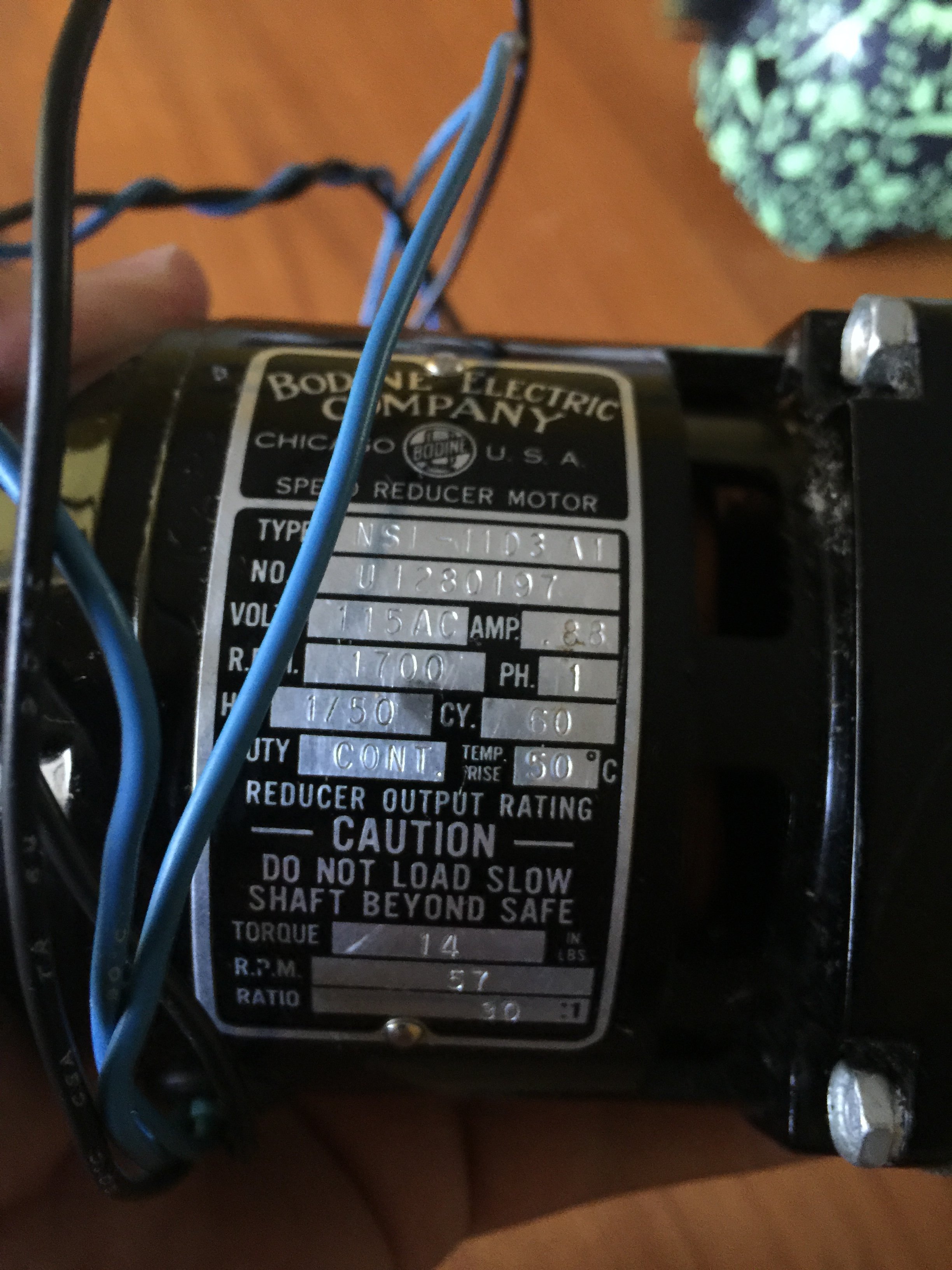

Hello all,
I have a project that requires a gear motor to be reduced to 1 rpm. Currently the motor is rated for 1700rpm, and already geared 30:1 for 56.7rpm. The plan for further reduction is to mate the shaft into another speed reducer of 50:1. I am interested to know what will be the best capacitor and arrangement to have this plug directly into the wall with a speed controller to perhaps get the range of rpm between 1.25rpm and .75rpm. We need the motor to be reliable for a lot of on/off. Motor also comes with two blue and two black wires.
motor specs - bodine 115 ac, .88amp, 1700rpm, phase 1, 1/50hp, cy. 60
Thank you - how do I know what size capacitor to use and what may be done to regulate speed safely and reliably?

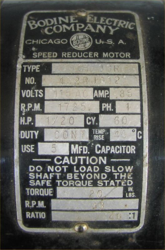

You have an old Bodine motor. I do not think your motor requires a cap to reverse direction and here is why:
Bodine motors that use a cap generally call it out on the name plate as seen above where it states Use 5 MFD. Capacitor.

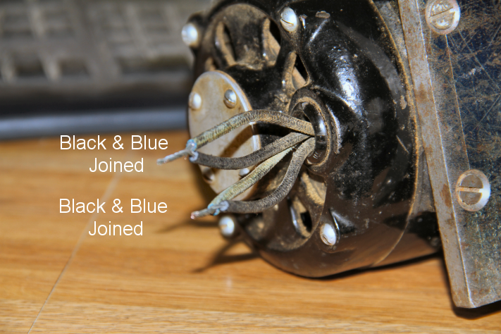

Here is what I suggest you try. Your Black and Blue wires should be Armature and Field leads. Blue for Armature and Black for the Field I think and don't hold me to that. Tie a blue and black together and the remaining blue and black together. Apply 120 VAC 60 Hz to each Blue and Black pair. The motor should run. Note the direction. Now reverse the two Blue wires and power it again. Does it run in the reverse direction? Let's see if that works.
Ron
Thank you - totally don't know what I am doing. Put a black and blue with power and the other black and blue to negative. Turned, and got lots of smoke. aye! Do you think I fried it?
Negative? It's an AC motor, what negative? OK, below is about what you should have. This is a pretty old Bodine Motor and one of mine. Like yours the nameplate states 115 VAC. The wires are actually blue and black but use the old cloth insulation which is pretty faded. This is what I meant when I said connect each blue to a black. That gives me two sets of leads which go to my 115 VAC (115 Volts AC) house mains power from a wall outlet.
Your motor should work the same. Can't immagine how you got smoke? This was a good motor correct or could this have been a bad motor? :)

Thank you Reloadron. Seeing your wiring, I believe I did perform proper connection. The only difference is I used a wire that had one of those old style on/off switches that looks like a fat tootsie roll and a circular roller. Thank you Tony Stewart for the service email and additional info.
