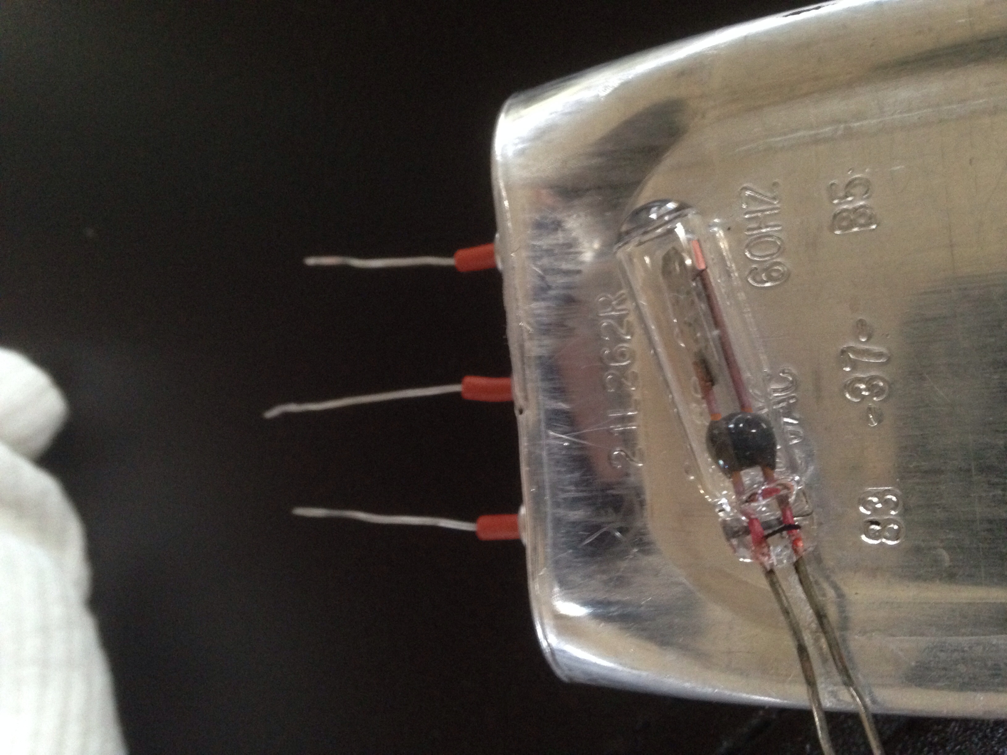

What about, say, 3.8-.05uf. At 320vac?
Just pulled one out of an old quick start ballast (no I'm not using one if those, I'll buy a new one)? Also, I found this evacuated tube with relay contactor looking things in it in the old crappy ballast (the cap also came from it, as well as a load of shoe polish- like wax or tar). Is it a fuse? Or a relay of some sort. It's about double the size of Christmas light bulb. Thanks .
Here they are:
Not sure about that cap, better not use it, th espec sounds ok, but 3 wires?
The glass bead is a thermal switch, I usspect in the application it acts like a timer, allowing the starter to work for a short period.
I looked it up. The cap is made of two caps connected in series if I understood it right. I think I know what to use though.
