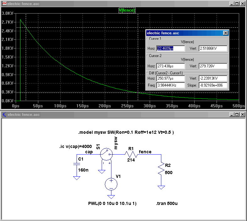

In any case, if you consider the equivalent circuit to be a 160nF capacitor charged to 4000 volts, in series with a resistance of ≈214 ohms, dumped through a zero resistance switch, you will get (I think) 0.9 joules delivered to a 500 ohm load, with a pulse width (90% to 10%) of about 250usec.
I also calculated that after the 250uS discharge there is still about 966V over the cap. The 2800V value may be because that voltages lower than 900V were found to be too low to have a desired effect, taking into account skin/fur resistance of the animal?
This was an error: See my later post
Here is a schematic and sim results of the model I proposed. Remember that WJoubert said the open circuit voltage is 4000 volts. As I said above, the pulse width is measured 90% to 10%.

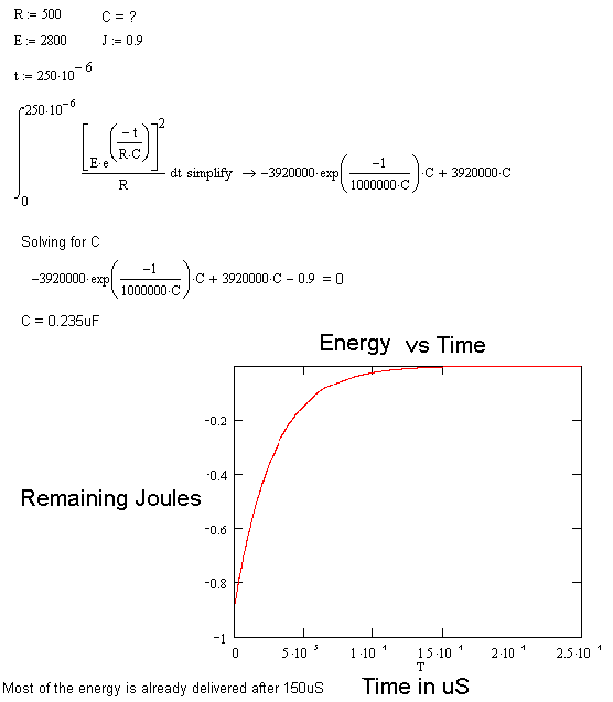

Looking at your graph there is something I can't add up. Does the green curve indicate the voltage over the cap while discharging into the 500 ohms, thus the part responsible for supplying the energy to the load?
The moment you start your discharge you should have enough energy stored to dump into the load. If I read your graph correct at the start of the discharge cycle you will have only [160nF x (2800v)^2]/2 = 0.63 J of energy stored in your cap.
Unless I am reading your graph/sim wrong.

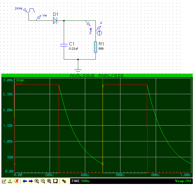

I think my original calculation was also flawed. I overlooked a factor 2 somewhere when doing my integration. The value should be about 1/2 of 0.47uF (0.235uF) ~ closest standard value 0.22uF
This seems to check out on simulation. 0.86 J at the beginning of the discharge, with 0.009 J energy left in the cap after 250uS.
0.235uF gives 0.92 J and 0.013 J after 250uS

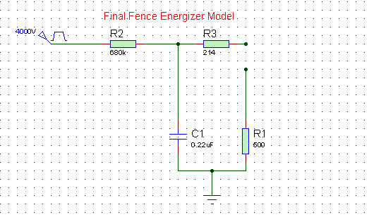

The 214 Ohm in Ron's circuit will give the required drop down to 2800V from 4000V the moment the 500 Ohm is connected due to voltage divider action. So the 500 and 214 Ohm resistors will be in series over the capacitor. The capacitor will be charged up to 4000V in the 1 sec allowed between energy pulses. The fence voltage will be taken from the connection between the resistors. So as long as the 500 Ohm load is not connected there will be 4000V at the open end of the 214 Ohm resistor. The moment the 500 load connects, the voltage will be divided down to 2800 and at the same time the capacitor will start to discharge.
The 4000V could be generated using something like a strobe psu and some capacitance voltage multipliers after the transformer from this example (you only need the part up to the transformer) and add the multipliers (caps and diodes) **broken link removed**
onto the secondary winding.
http://www.hut.fi/Misc/Electronics/circuits/strobo_12v.html
Because of the light load the inverter should draw little current and the 80mA from 12V should be possible. (you have 1 sec to charge the cap every time) With a 680k resistor from the 4000V supply to the cap, it will charge up in about 0.8 sec, with a peak initial current at 6mA and tapering off towards zero after 0.8 sec

Here is the way I analyzed it:
Rsource=Rload*(Vopen-Vpeak)/Vpeak
Rsource=500*(4000-2800)/2800
Rsource=214.3
Jout=0.9
Jtotal=Jout*(Rsource+Rload)/Rload
Jtotal=(214.3+500)/500=1.2857
The basic equation for energy stored in a capacitor:
J=0.5*C*V^2
Solving for C,
C=2*J/(V^2)
C=2*1.2857/(4000^2)
C=161nF
Tau=(Rsource+Rload)*C
Tau=114.3usec
If we define pulse width from as being from 90% to 10% (arbitrary maybe, but fairly common for an exponentially decaying pulse),
Pulse Width=2.2*Tau=251usec (I bypassed the derivation of the factor 2.2, because it is well known).
Admittedly, 0.9 joules will not be delivered during the 251usec, but I think the manufacturers could have used the same thought process to come up with total energy first, and then derived (or measured) pulse width afterwards.
The difference between TheOne's derivation and mine is that he constrained the 0.9 Joules to be delivered within 250usec (with some energy remaining in the cap), while I calculated the capacitance required to deliver 0.9 Joules, then calculated the resultant pulse width.
This has become just an interesting intellectual exercise, and I don't know which method (if either) is correct, nor do I particularly care. :D
