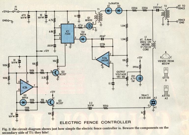

OK here's the circuit I used for the fence controller. I do have a second kit but I might beef up the stepup trnsformer to give me 10 kw instead of 3.6 kw that should provide a good scream.
:twisted: :twisted: :twisted: Bryan :twisted: :twisted: :twisted:
