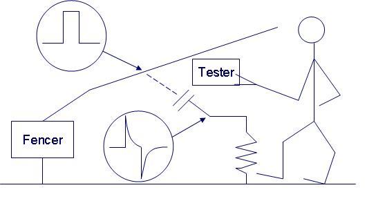

Last night on the box a bloke was showing an electric fence checker that showed if the wire was live by just placing a unit close to the wire not touching it and the unit just sounded a beeper. He mentioned it picked up the static (electro magnetic interference) of the fence. Anyone got any idea's how this would work as I'd be keen to learn more about it.

Bryan,
I would try a small portable radio, tuned OFF a channel, hold it close to the wire, [not too close] if its a pulsing fence you should hear a click, click.
Here is my best guess, see the attached sketch.
In the fence wire is a high voltage pulse, by holding the tester close to the wire there will be some capacitive coupling into the circuit in the box.
There will also be a resistive path the ground through our little stick man*.
At the junction of the capacitor and resistor there will be nice spiky pulses which can be used to trigger a beepy thingy.
So informing our man "dont touch this you great galah"

I need to find electric wires under ground. (60hz 220v)
I built two different “boxes”. The first one worked much like JimB suggests where the antenna is a copper plate that capacitive couples to the power line. The second box picks up the magnetic flux lines from current in the wires. They both work.
I think detecting electricity in a fence is much easer. Higher frequency components, higher voltage, much closer to detector,……

The old style testers used a neon light with a current limiting resistor, and a nail you pushed into the ground
You *can* pick up the pulses from an electric fence with a simple capacitive FET detector circuit. I designed several fence energisers with alarm and monitor circuitry for perimeter protection of small properties, with rubber soled shoes on a dry day it hurt like crazy ! I would NEVER have tried with bare feet. Testing the output without a direct connection was tricky.
Just hold a neon lamp next to the fence and it should flash when there's a pulse.
Small fluroscent tubes will work and even an energy saving light bulb.
