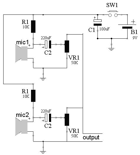

Hi - I´m planning to build a mic system for my accordeon, and I think I may need some help to design a pre amp circuit.
The plan is to use 3 electret mic capsules on the treble side of the accordeon, and 2 on the bass side. The mics will be wired to a pre-amp/mixer/battery box that can be velcro´d on to the outside. I want to have 2 separate output channels, one for each side, so I will need one set of 3 imputs mixed to one channel, and one set of 2 inputs mixed to the other channel. I will need to use preset resistors to trim the levels of each mic to compensate for differences in sensitivity, and I want to have one volume control for each channel. Of course, all this needs to be in quite a small circuit. With that in mind, I´m thinking I might have to make do with one pre-amp for each channel, with a pot to control the gain, and just use a resistor mixer, with presets, to mix the different mics to each pre-amp. Would that be a bad idea bearing in mind the fairly low impedance of the mics though? Should I use another tranistor pre-amp stage for each mic before mixing?

Unless you play very softly I believe the resistive mixing will work fine. You will be close micing. 10,000 ohm log taper pots and 6800 to 10,000 ohm resistors in series to power each mic (9dvc) has worked for me in the past. I used 100uf isolation caps, if I remember correctly.
Cheap electret elements are fine but make sure they can take the input level when you play load without distortion.
Thanks flat5 -
I would hope to buld something that can handle a full range of playing levels, from 'very soft' to pretty damn loud, as I will be using it for studio work and experimenting with electronic effects, not just for gigs.
I would think that playing very soft will still produce a reasonable signal with close mics, but when I´m blasting it out it´s possible I´ll have problems overloading the electrets. I think I will try with the normal electret configuration first to see if there are any distortion issues, but I might consider also modifying the mics to a Linkwitz configuration to provide some source feedback resistance, which apparently increases the headroom considerably...
It seems this will also reduce the output voltage though, so maybe that will then cause problems at lower levels... experimentation is the way I guess.
On second thoughts, I think it will be tidier to have a small internal mixer circuit in each side of the accordion. If I can get away with resistance mixing to combine the signals several mics on one side it should be easy to make a circuit small enough to fit inside, and then I can have just one coaxial cable from each side leading out to a battery box with 2-channel pre-amp and gain control. That´d be a nicer solution.
One thing, you said
"10,000 ohm log taper pots and 6800 to 10,000 ohm resistors in series to power each mic (9dvc) "
I´m slightly confused by this, you mean to put a pot in series with the power supply resistance? (from +v to signal out of the mic?) To mix the signals shouldn´t the pot be between mic out and pre-amp input (mixing point)?
By the way, I´m thinking of using this pre-amp circuit...
electret-mic-preamp2-png.15442

Now I see your circuit. It looks good. I don't think I would do the gain the same way. I would put the pot on the output or input, depending on what follows. But the designer may know better.
Would you use an amp for each input or each channel?
My circuit may be all you need for club use. For recording you may want something quieter, like your circuit.
Had time to think and changed my terrible circuit.
I think this is about all you can expect from a 3 input resistive mic mixer. Just not sure what is the best pot value.

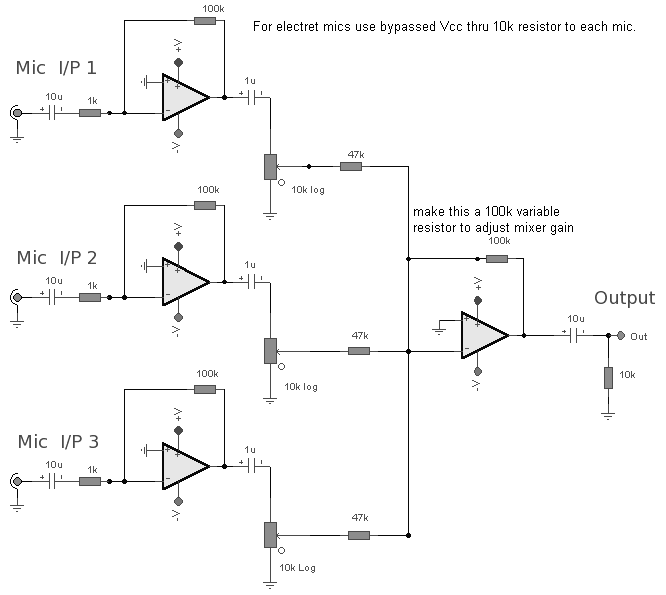

It's a really horrible design - I hate to see pots used the wrong way like that :D
Why not use a simple virtual earth mixer?, one opamp, job done (and you can get the added gain you're looking for), although personally I'd like to see a preamp following each mike before it's mixed.

The passive mixer circuit you sent looks like the sort of thing I was thinking of, Flat5, to feed into a 2 channel pre-amp. The circuit I posted was what I intended for one channel of the pre-amp, not for each input, so the mic input in that diagram would come from a passive mixer like the one you showed.
I´m not sure about what you were saying :
The pots have to be backwards or they interact to much.
Can you explain that a bit? If I set up the pots with the wiper to the mixer output what problems does that cause? I don´t think I need to worry about crossfeed at all as this mixing stage is just to level out each mic by a few dB with trims.
The virtual earth active circuit looks good too. I think active mixing of the mics would be advantageous for sound quality, but as I say, I have to be careful for space if the mic mixing stage is going to fit inside the cover of my accordion. Would something like this with transistors instead of op-amps work?
The pots have to be backwards or they interact to much. Can you explain that a bit? If I set up the pots with the wiper to the mixer output what problems does that cause? I don´t think I need to worry about crossfeed at all as this mixing stage is just to level out each mic by a few dB with trims.
You can't just join pots together, they short each other out, by fitting them backwards it helps reduce this, but they don't really work correctly.
Sound quality, and it would mix properly - opamps take little room, one quad opamp would do. If you're really tight for room then use a surfacemount device.
