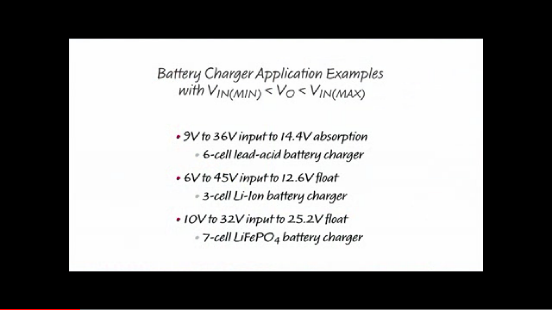

LTC4020 supports these Buck-Boost topologies with different battery chemistry shown below.

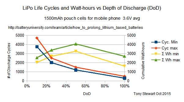

Experience in extending the Lifetime Watt-hrs on LiPo cells, reported at Battery University, concluded that reducing DoD to 10% and reducing temperature max to 30'C by reducing C rate and ambient significantly..
Chart to follow
https://batteryuniversity.com/learn/article/how_to_prolong_lithium_based_batteries
WHat this study shows is if you Charge a 1500mA pouch cell Mobile phone battery with 1C and drain with 1C such that 100% DoD = 3.0V and full charged is 4.2V you get 500 cycles of life or 2700 watt-hours @3.6V*1.5Ah=5.4Wh per cycle consumed in 1 hour (1C)
What this curve shows, that I made , is you can expect up to double the lifetime Watt-hours if you regulate consumption near 50%. Battery suppliers often ship at 50~60% SoC (or 50~40% DoD) to maximize shelf life for a reason. Test results courtesy of Cadex.
This comes at the expense of 4x as many charge cycles but may well be worth it if you have twice the capacity that you need in a single charge.
