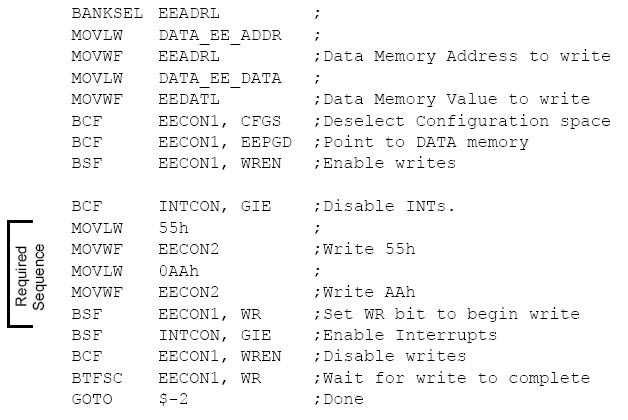

Here is the EEPROM write procedure for the 12F1840:
Why is the last step "GOTO $-2" instead of "GOTO $-1?"
Other Microchip documents I have consulted, such as DS31007A do not explain the need for clearing WREN more than once.
John
There must be a bit missing here!!! WREN has to be set before the write then cleared after the write..

The goto $-2 is to go back two lines to test again.. Once the test is clear the goto is jumped!!
Yes, to save space, I only showed the clip clearing WREN however many times it takes for WR to clear. Here is the whole Microchip procedure:
That doesn't change my question, though.
From my little understanding of C, you just sit on WR and wait for it to clear, which is what a "GOTO $-1" would do. I guess since your program works, I will just use the $-1 too.
Since the one of the stated purposes of WREN is to prevent accidental writes to EEPROM, I also wondered why the MC sequence enabled interrupts before ensuring that the write was completed. Since I am not using interrupts, though, that wasn't an issue. Your sequence is better and makes sense, but I would still clear WREN before enabling GIE, if only to be completely done with the EEPROM write before moving on.
I have used flash memory before, and effectively that (i.e., finish the whole process before enabling interrupts) is what I did there. Does flash memory take longer to write than EEPROM?

Are you sure that code is for a 16 series chip and not an 18 series?
Edit, just found the datasheet and I think it's just been overlooked when copied from a 18 series datasheet. It's one of the reasons why I hate the use of goto $-n type code, it's just not good practice.
I had many issues with eeprom writes so I moved the interrupt out of the way and only then disabled the write protect... I have never had an issue since...
The goto $-1 only loops in one line of code..... To go back to test the WR flag you need to step back twice!!!! ie.. goto$-2
other wise the code would hang as the goto $-1 is a forever loop...

At what stage during the (pipelined) execution of an instruction does the program counter increment? If early on, then wouldn't $-2 be needed to loop it back to the BTFSC instruction?
Pommie: That snippet was directly from the 12F1840 datasheet. I guess one could say it is a 16 series. Definitely not 18 series.
Ian:
I use this test in everything I write:
$-1 goes back one step. If it didn't then the code would never run. I use GOTO or BRA depending on the chip, but for that step, it really shouldn't matter.

I see what you are driving at with the fetch process MC uses, but that is not how the "GOTO $" instruction/operator works. From the MPASM instructions:
Thus, "$" is the PC for the current instruction, and "$-1" counts back to the just previous instruction. Whether the instruction is one or two clock cycles does not affect the PC.

They are not the same. "goto $-1" goes to the PREVIOUS instruction, which needs to be a branch, such as BTFSS/BTFSC. If you did something like a "NOP" as the previous instruction, then it will loop forever or time out. I have seen examples of doing that intentionally, but it is rare. The "bit test, skip if true" instruction provides an escape from the loop.
As for waiting for the oscillator to stabilize, when using a LF tuning fork oscillator (e.g., 32.768 KHz), the time for a stable signal (I used an LED when that bit flipped) is quite noticeable. When I simulate with MPLab SIM, which doesn't use the chip's oscillator, I comment out those two lines. On occasion, I have forgotten to un-comment the lines and programmed the chip. Proceeding without a stable oscillator can give unpredictable results.
BTW, except for this particular and similar situations of testing a flag, I rarely use "goto $± x". I use a label as Pommie suggests.
John

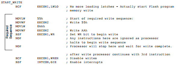

Just looked for an errata on this question and found nothing. However, for the newer 12F1822 chip, MC has changed the recommended EEPROM write example to:

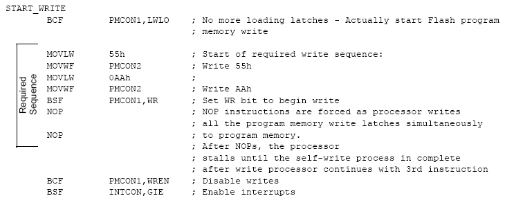

Note, it no longer checks the write complete flag (EECON1,WR), and has substituted two NOP's. The write enable bit is then cleared followed by enabling interrupts. That sequence is similar to the recommended sequence for writing to program space, e.g., this sequence from the 16F1519 (2013 version):
Of course, "PM" denotes a write to durable program memory space, not EEPROM, but the transliteration from one sequence to the other seems obvious. In fact, the suggested sequence for writing to flash program memory of the 12F1840 (2015 version, Exampl 11-5 at bottom) is identical, except for substituting EE registers for PM registers:
So, I will just try the two NOP's. Sure wish MC had a little better consistency with its current revisions.
John
Thanks, John. I've done little PIC programming and never used the $ designator. It shows!
My Apologies.... I have just done a test.... I don't play with asm enough anymore....
goto $ is the forever loop!! Sorry, I should be made to eat humble pie....
I think someone at Microchip has copied the code over without thinking (As i did)..
The command should be goto $-1 as you have been saying.... ( BTW I tested it on a pic12f1840!!! )
Here's my conclusion. There are at least four options for that segment of code:
1) It is really necessary to keep clearing EECON1,WREN and the reason is not documented.
2) The $-2 was a typo and $-1 was intended.
3) Going back an extra step was needed to waste a little more time, knowing that no harm is done by clearing WREN multiple times.
4) This particular section was not updated along with corresponding sections for similar chips.
I suspect the answer(s) is #3 and #4; however, a comment certainly would help at that step. It is probable that the 12F1840 processor stalls in writing to the EEPROM just as it does when writing to flash program memory, since the same registers are involved.

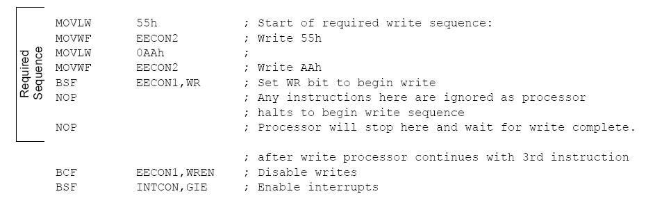

REQUIRED SEQUENCE TO WRITE TO FLASH PROGRAM MEMORY (12F1840 datasheet):
I hadn't noticed that the EECON registers were being used with the 12F1840 when writing to program memory. My previous experience was with the 16F1519 for which the registers used to write to program memory are named differently (see: post #13, middle image). My bad.
Conclusion:
I will just add two, NOP's and omit checking EECON1,WR. If that doesn't work, then I will add that check. Writing to program memory can be simulated with MPLab SIM and the 16F1519, but there are things that simulate with the 16F chip that don't with the 12F chip (e.g., capture), so I can't trust the simulation to tell me it isn't working.
John
