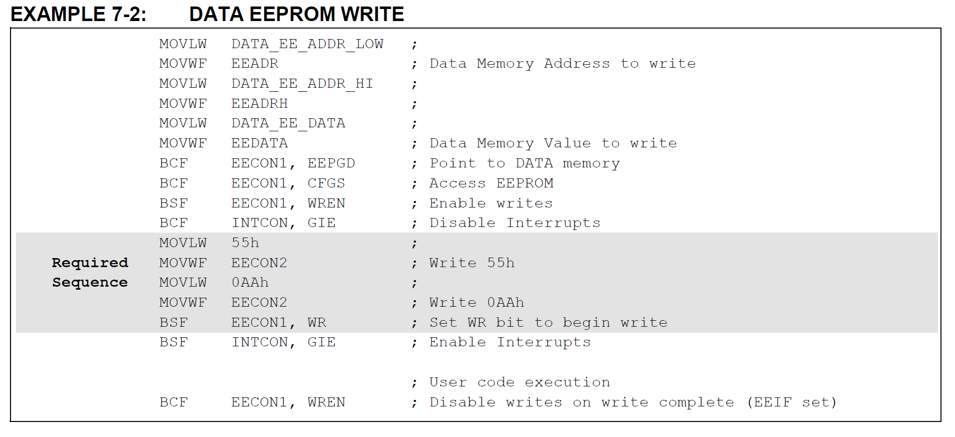

I am using MPLab and MCC on a PIC18F45K22. My question is if I write a float to the eeprom will the address counter increment itself for the four bytes or will I need to use a for loop and advance the address counter?
The datasheet doesn't say?

I would think it doesn't auto-increment though since I also did not see it anywhere in the datasheet where I would have expected to see it.

There's only a single write there, the 0x55 and 0xAA are simply to make the write happen.
Yeah I just noticed that was a unlocking sequence. I thought it was weird they overwrote the same thing to the register and then set the WR bit.

To store a float is easier if you serialise it... A float is 4 bytes so
union{
float x;
unsigned char serialise[4];​
} storefloat;
// writing
for(x = 0;x<4;x++){
writeeeprom(x, storefloat.serialise[x];
eepromwritedelay();​
// reading
for(x = 0;x<4;x++){
storefloat.serialise[x] = readeeprom(x );​
Sorry! I misread the OP... I see what you mean... You want to write all the bytes in one go..
Normally serial eeproms have a "Housekeeping" which means if the eeprom supports page writes an entire page may be written to a scratchpad ( sram) and transferred internally... I do not think the inbuilt EEprom supports page writes on a PIC... So single write may be the only option..
