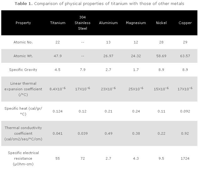

Nevermind I found a really awesome chart here https://www.azom.com/article.aspx?ArticleID=1298
Harder to find straightforward info like than I would have thought.
Here's the chart:
That information might lack some of the exponents the SI units have, but the resistance value for copper seems to be a little (i.e., 10^3) too high. ;)
