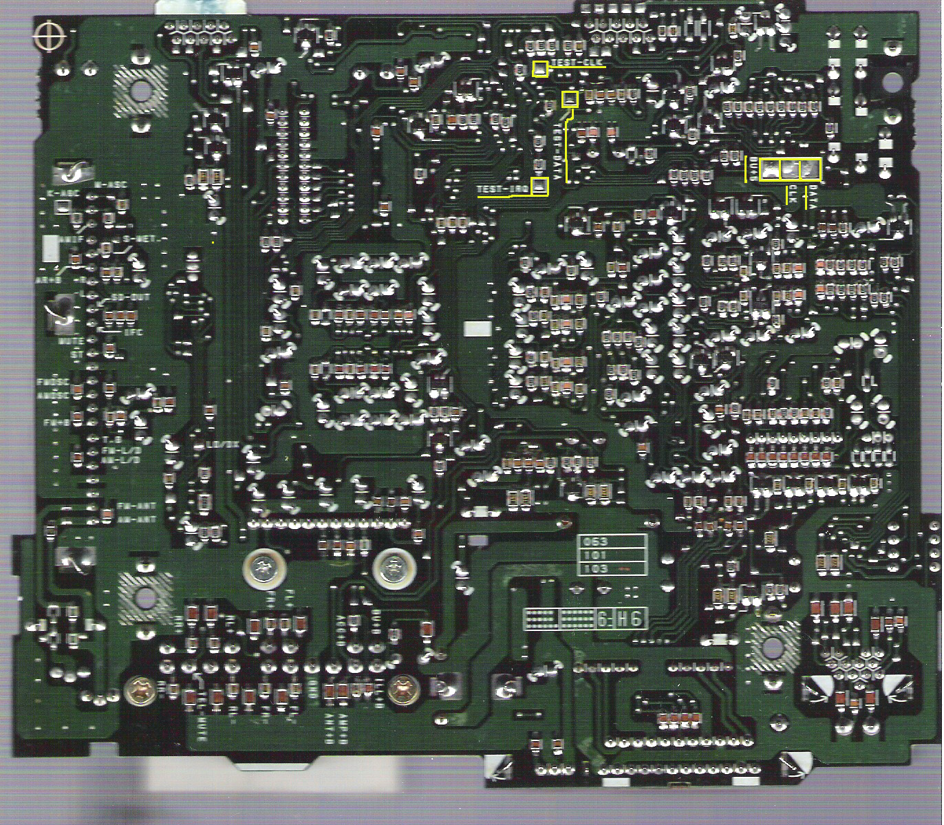

okay i got bored today and decided to completely disassemble the head unit so i can see if there was anythign written on the board. well i found a few interesting markings. there are three other solder points that read "test data", "test clk" and "test IRQ" and the three known solder points read "data", "clk" and "BU+5". i'm starting to think that it's not the three points that we already knew about that need to be jumped but the coresponding new ones:confused: . worth a shot, i figure that it is pretty much worthless as it sits so there is really no damage i can do to it. i also found a reset button on the face (probly does nothign but resets the stations and clock but never seen it before till i took the face apart). i'll probly take it apart again and hook it up to a 12v source on a bench so i can mess with it some more to see if i can get somethign to happen. oh and here is a scan of the board and the new points i found highlighted.

it's not a jumper that gets fitted, it's a serial data stream, upon power up the data is put across the bus, they merely read it off and enter in the unlock code...placing a jumper anywhere may well damage the port feeding that data then you really won't be able to get it decoded...
Are you saying there isn't a way to unlock it other then by the actual unlock code?
i think that might be for the newer ones only:confused: . i don't know but mine is pretty much worthless as it sits so i'm gonna go poking around at it to see if anything happens
The unlock code is most likely stored in the flash memory or eeprom of the main micro now. Years ago most of the manufacturers used to use a seperate eeprom only to store it, but as it was easily hacked they moved the security into the main micro. It's not so easy to get at now, and can only be read as the unit powers up with the right equipment. If you go poking around inside it, there is the risk of damage. It would perhaps be better to find someone with the right tools to unlock the thing, and then as an eariler poster said, disable the protection scheme altogether to prevent it inadvertently happening again.
If you want to decode it yourself, start off by finding out exactly what the data stream is, and what protocols it's using...and work from there...
