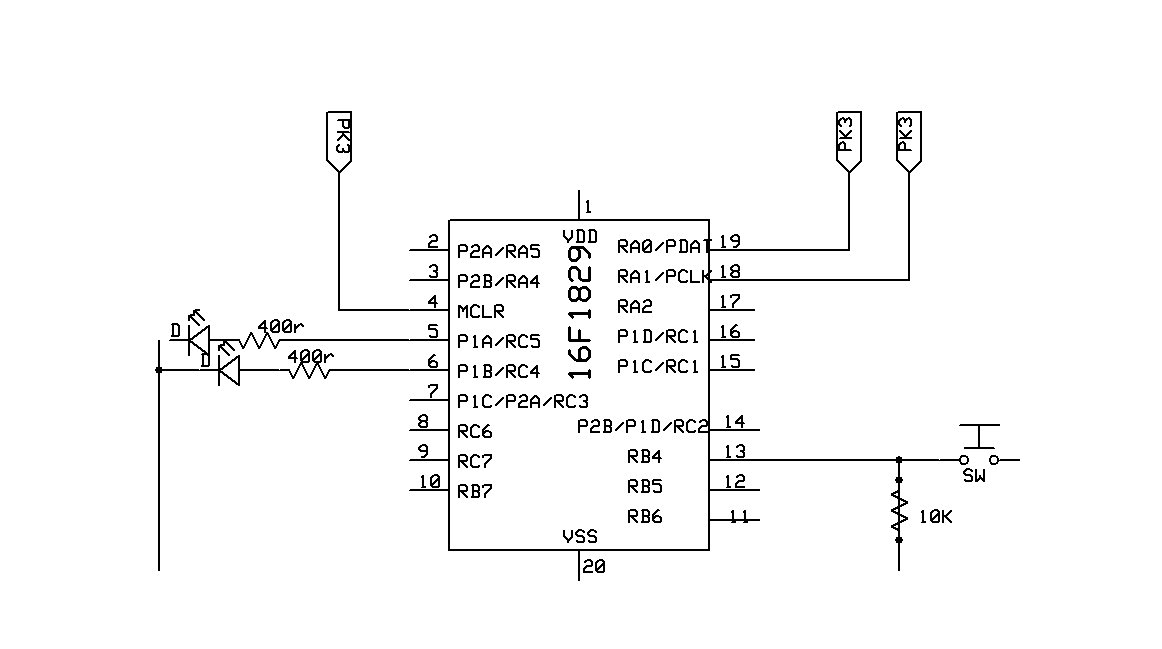

I am trying to set up my ECCP1 on the 16f1829 to output single waveform PWM to two pins--right now P1A and P1B. I get a good build (other than bank errors) and the Pickit3 says it programmed. I am working on my turn signal controller--just experimenting now.
https://www.electro-tech-online.com/threads/stuck-planning-my-turn-signal-module.123061/
Attached is the schematic for my basic test circuit and my rudimentary code. I started with 16f1827TEMP.asm since there are no 1829 templates available. I am trying to make the 2 leds light up at 30% duty cycle, then go bright to 90% for the button press, then dim again when the button is released. Right now I get NOTHING. What did I miss please???
Thank you!!!!!!

I have tried running it through MPSIM and i am not getting any values loaded into OSCCON or CCPR1L when stepping through and watching the Special Function Registers window. The TRISx and CCPTMRS registers are not changing either. I tried using the hex value from the memory map (datasheet) as well as the 'common name' as referenced in the .inc file. This is confusinating.
Is anybody out there??????
And it looks like the comments on the CCPTMRS has the CCPx assignments upside down. TMR6 is assigned to CCP1, but only TMR2 is initialized. Try a clrf CCPTMRS to start with, and you know that it's TMR2 for sure, then build out from there.
THANK YOU!!!!!!~!
I see I was also selecting the banks incorrectly to load the values. Once I fixed that I got values loaded into the registers as they should be. I have not checked the timer setup yet. I will. THANK YOU!

I fixed your code banking and tried it last night nic is right about the timer I been looking at the data sheet and it got late so i didn't post any thing
When i get home I'll post what I did if you want.
There a logic Analyzer in mplab that you can use it's under View at the bottom.
nickelflippr. Thank you for the heads up on the timers. I found it too. It is like proofreading my own essay, I miss obvious stuff. ADD what? :-} OOOOh look at the birdie.......
be80be. Thanks for looking at the banking. I'd love to see how you did it. I am sure it is much more elegant than what I did. Thank you again.

I get a nice PWM output on CCP1 (the same as P1A and RC5) which corresponds to the ECCPA signal. I get nothing on the other P1x pins as it should. I will play with the PSTR1CON register to steer the outputs to different pins.
Now to test it with the hardware.
