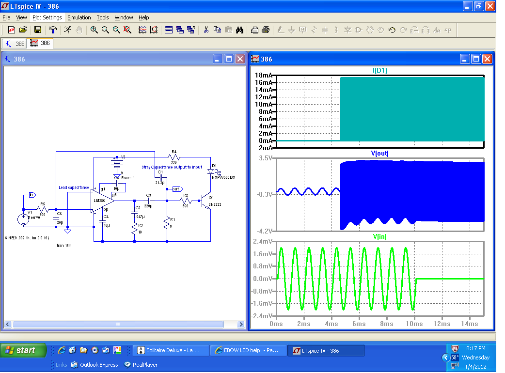

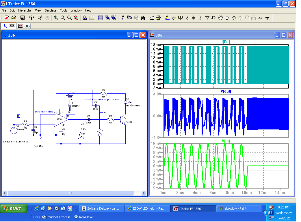

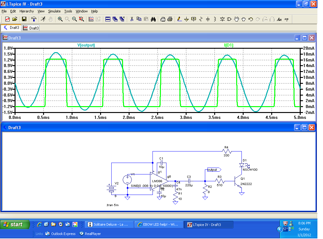

Here are a series of simulations that show what I think is going on:
I have inserted a small amount of capacitance between the output and the input. This could be present if your output and input wires are close together. Also added some capacitance across the input cable that I think might simulate your twisted pair in the picture.
The first picture is with 300 ohm source resistance and an input that won't light the led. Notice it takes a bit for it to break into oscillation, but when it does it continues - so bright LED.
Second picture is with a higher signal input. Notice how it is on and off. Dimmer LED.
Third picture is with 8 ohm input. No oscillation because of the low input impedance. So now the LED lights only when the signal is present.
The trick here is to find out the feedback path. I would move wires around until the LED goes out with no signal present.
