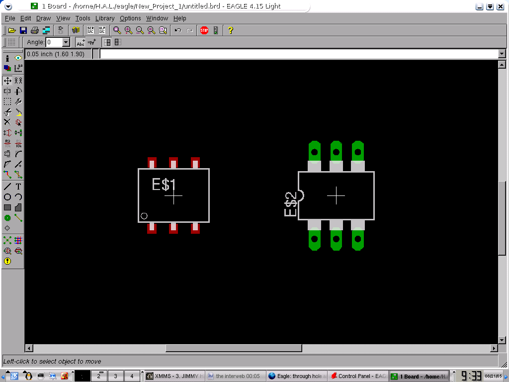

Since Ive been starting to use SMD, ive run into a problem:
Whenever you place a component, whether it be SMD or through-hole, pin 1 always comes up in the same place: upper left hand side. Shouldnt SMD stuff have pin 1 in the upper right hand side?

Ok, actually pin 1 is on the bottom left by default, my bad, but that doesnt matter :lol:
My point is this: On a one-sided board, SMD is on the bottom of the board and throughh-hole are on the top of the board. If you are looking at a SMD chip and a through-hole chip, pin 1 will be at the same place on both chips. Flip the SMD chip upside down, like you would for a single-sided board to place it on the bottom, and pin 1 will now be mirrored relative to the through-hole component. This is not the case in eagle though: Take a look @ my screenshot.

Oh I see.
So what we're saying here, is that when using Eagle, viewing the circuit from above, top side up, if you add a SMT component on a single sided board, you need to select the bottom layer (or the bottom side, where the copper is) and mirror the component yourself... Or somehow flip the board, just like you'd do in real life, place the SMT component, and then you'd see pin 1 top left when going back to original top side up view.
Am I understanding this right?
In the pic above, the SMD component is still on the top of the board.
You want want it on the bottom side, correct?
If you perform a "mirror" on the component, it will go to the bottom layer. You will notice that the pins turn blue (instead of red). The pins should still be in the correct position (if you imagine yourself looking at the bottom of the board)
I haven't experienced any mirroring problems by doing that.
Like Phasor said, you need to 'mirror' the SMD part. It's the button right under the 'move' button that is currently selected on the screenshot above. The outline colour should turn blue. The SMD placement defaults to the top layer and you want it on the bottom layer.
