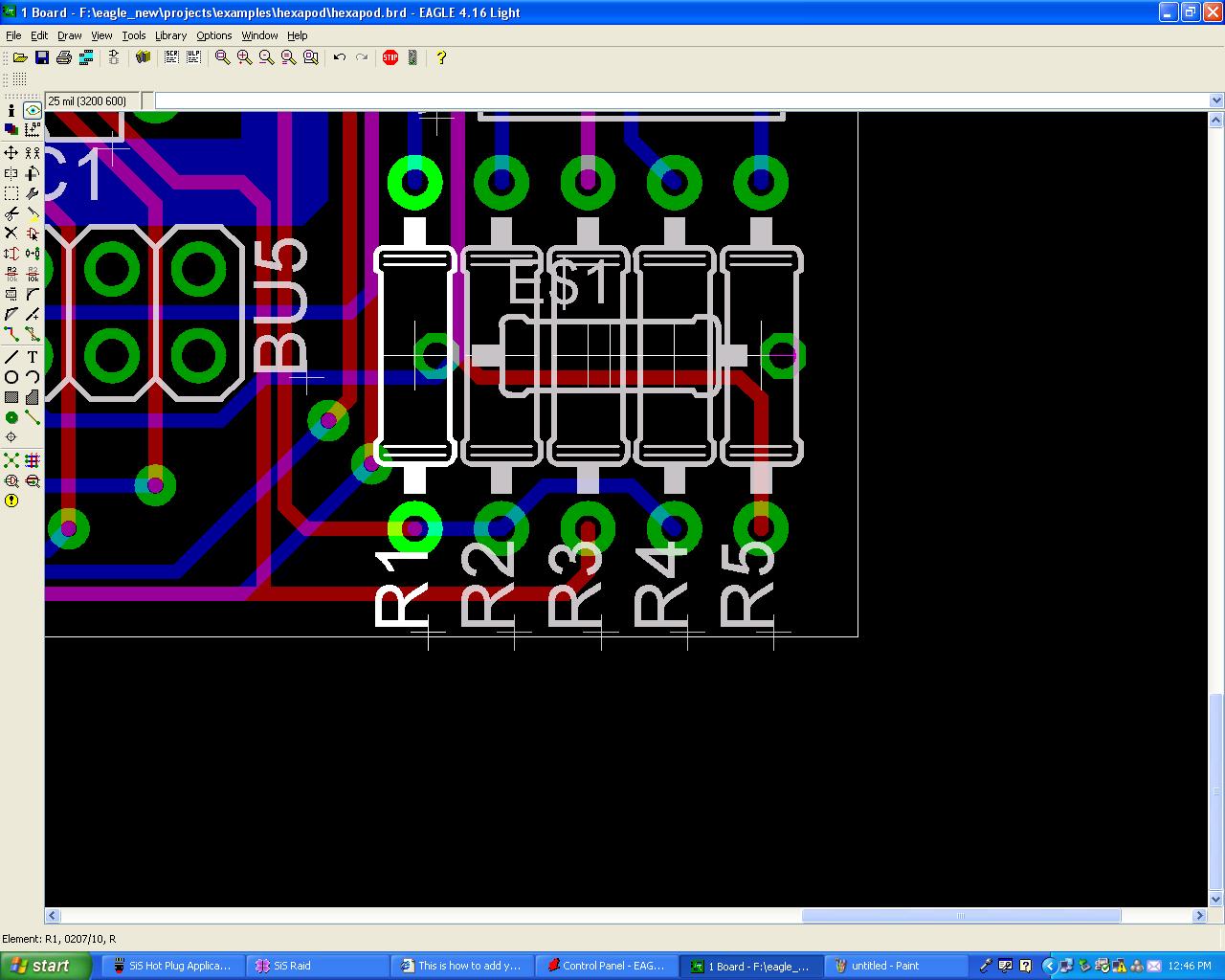

I am driven into deep frustration... :x :x I can't get a particular package for a resistor.. Here's what I want... Part: 0207/10,R,0207/10
When I choose a resistor, I normallt go into rcl lib and choose the US Resistor menu and choose 0207/10 part... the problem though is that this package has a octagonal shaped pad ... thas the reason why I had mentioned my concern for increasing the dia of the pad... BUT there is a file called 'hexapod.brd' in Eagle which has resistors in the 0207/10 in r.lbr which has a round shaped pad... WHICH IS WHAT I WANT...
I just cant find the r.lbr in the library tree ...
ps: I have the Eagle 4.16 Edn for Windows Light Edition
Request you to please help me out ... the PCB designer has asked for rouned pads only :(
Here's the attachment.. note that I have highlighted the resistor with rounded pad package and have placed the resistor with octagonal package.. once again my query is HOW DO I CHOOSE THE ROUNDED PACKAGE RESISTOR ?
This is one of Eagle's major weaknesses, very poor database management of parts.
I don't know where to find r.lbr, but if you can load the hexapod board, the r.lbr has to be available or it wouldn't be able to load it.
You can take the "normal" rcl resistor library and simply make a new resistor package with round pads, then add that to the resistor component as another package option. The downside is that if you install a new copy of Eagle, it's going to copy over that stock library and clobber it. And if you deliver a design relying on a modified rcl lib the recipient is going to have trouble opening it without clobbering his own rcl.lib file, which would be unfortunate if he modified that file for his own purposes. So I kinda recommend a myComponents.lbr that will never be clobbered. The downside then is that there's no existing array of resistor packages, symbols, and components in your lib. This is the evil of Eagle's lib management.

Nope, tried like hell.. cant find that library ... looks like they'v made this board in some other edn of Eagle(which has r.lib) and then included this in my edn ... However I can copy the package ... so maybe the package is hidden in somewhere ??
all the versions of Eagle I've worked with keep the regular resistors in rcl.lbr ... I've never seen r.lbr!
so if you want round pads, then copy rcl.lbr to a different directoy (outside eagle), and name it something like rcl-roundpads
now open that library, and edit the parts you need to have round pads
save your changes, and go into your schematic
type this command
UPDATE rcl = c:\newlbr\rcl-roundpads.lbr;
the semicolon is important, it tells eagle to check all parts
this will replace any and all parts in the old rcl library with parts from the new library
alternately, you can also do a CHANGE PACKAGE and specifiy a different package from a new library, but I can't remember the exact syntax for that.

my problem c' is that J does not arrive has to find the libraries eagle 4.09r2 for the components tlc4950 and MINI ARDUINO, jai already tested some examples that J found on Internet but malheuresement they were compatible qu' with Eagle 5.6.0 and c' was not accepted by the version that j' , version 4.09 thus I have N C not how to find them, Ca really disturbs me, can you find me a solution?
If you can not find the part you need you can create it.
the mentioned package is contained in Eagle 5.5.0 rcl.lbr.
However the order is not logical. In the list you'll find 08XX first followed by three digit numbers all starting with '1'. Scrolling further down the sequence starts again with leading zeros. Package 0207/10 is contained in the list. Click it to have the package displayed.
Then click 'Change' and select 'round'. Click on the pad and it changes from octagon to round.
Save the original package (including the change) or copy and paste it it to have two different kinds of pads for the same package. (Save the new package as 0207/10-R)
Don't forget to create a device for that resistor, using the same symbol and the new package.
Once a package is used with a device it can't be changed on the PCB.
