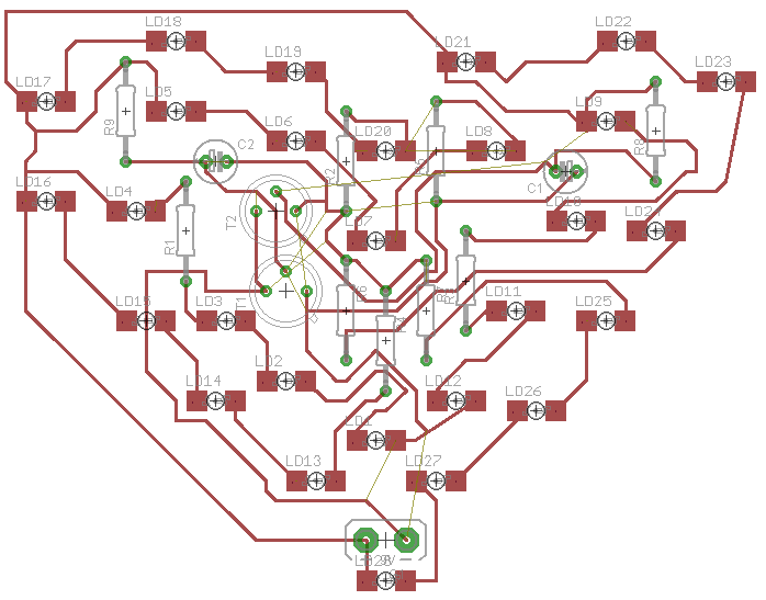

Hey,
I am attempting to etch my first board using eagle 5. I have a velleman kit which was the first board I ever tried to solder, and messed up. It was a present from my gf (as I am sure you can tell from the pics)... I assure you, I can solder better now :)
I got the schema for the "sweetheart led" board online and drew it in eagle. I then placed the components and attempted autoroute. The most this could drew was 94%. After hours of trying to make eagle route it for me, I decided to draw the lines to see it worked just once.
For some reason, eagle thinks I haven't got the connections right? I can't understand this at all! I copied the connections DIRECTLY from the board.
Below are screenshots, and I have attached the board and schema from eagle in a zip file.
I am sure the error is mine but I can't tell what it is!!! If anyone can spare a minute to help me I would massively appreciate it.

If you still have air wires then either the schematic or the layout is wrong. Match them up and figure out why.
You can also hit the ratsnest button. Sometime the airwires get confused and just stick to places they shouldn't.
Unfortunately I tried that ...which is why I know I got a problem :(
I got the schema from velleman and the board is exactly the same layout as the actual board I own. Any other ideas?
Would eagle tell me if I connected something that I shouldn't?
It is asking me for resistor values... surely this doesn't make a difference? Or does it?
You get a little 'bing' sound and the trace locks on when you connect to the right spot. Unfortunately Eagle has no problem with you putting traces on the same layer over each other. That kind of thing is only found with a Design Rules Check.
I downloaded your files. I didn't realize you posted them.
I don't know what more to tell you. Either the layout is wrong or the schematic is wrong. Are you sure the PCB doesn't have any top traces or jumpers? Using the little 'eye' icon on the toolbar helps with this kind of thing as it will highlight a full net on both the schematic and the board layout so you can see where everything is.
Awesome. This sounds just the thing. Just click on a couple of items and it maps them nicely. This should be a quick means of identifying the problem!
THANKS!!!!! :)
Yes, I used the show tool and clicked around a bit and you definitely have nets that are connected to traces that they should not be.
I copied it perfectly! When I hold the board up to the light I can see there are no other traces/vias.
I did a show on one of the traces. You are connecting nets that don't connect in the schematic.
I'm thinking you've placed components differently than they are on the reference board. You also have an issue since you are using the copper on the top of the board (red) and your components are also placed on the top of the board, so your transistor pins are reversed.

Hey,
I looked over your board files and the schematic looks fines. However, the board routing is a mess. Besides the unrouted airwires you also have several short circuits if you left the routing as is.
Personally, I have never had much luck using the autorouter and I just don't like the looks of it ( not that it maters much, just my personal preference ). You should be able to manually route this board without too much trouble.
Be sure you run the ERC and DRC to find those problem areas.
Good Luck!
try this
Since I had the file open I relocated a few resistors and rotated a few others and got the complete autoroute. You should check this completely before you use it. Better yet.. see what I did and try it yourself.. best way to learn is by doing.

That's impressive, sir! Thank you. I totally agree about learning by doing. Hey that's why I am playing with eagle in the first place :)
I have actually just been rearranging the components. Flipped the board layout around, my transistors were the wrong way round.
I got a photo of the board, made it a 2 colour bitmap, made it a package and used it to draw the lines backwards :D
I am now 98% complete! Can't work out why the last 2% won't play ball though.

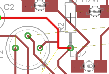

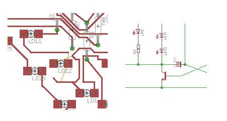

This is the problem bit. Eagle is suggesting a different connection to the board? Every other connection maps except one????? Also, if I made the connections it suggested, I would connect the cathode and anode together? No?

This is how eagle wants me to connect the led. Clearly these connections don't make sense. Why is it doing this?
This is how I believe it should be connected. But eagle is still expecting more lines...
Woooooooooo! 100%!!!!
There was a small dot of connection around the led. Even though I moved the led a thousand times to look for it, i didnt see it until i accidentally clicked on that exact dot.
