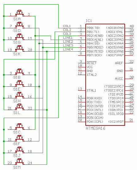

Hi Gayan,
I guess the reason for this is there are so many keys on the market which would fill a library of a few MB.
If you tell me the key type I'll be happy to make the proper design for you. I'm used to making packages with an accuracy of 1/1000mm.
I also would need info about how you place the keys in the schematic considering a neat layout. May be you want to place single keys at the proper location not to mess around with "twisted" nets.
As I understand you require three columns and four lines matrix coded.
Here is an example I just made.
Regards
Hans

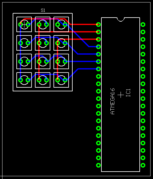

I added my own. I can post the library file if you like.
Here's the LBR file. It was made a while ago and so is a bit amateurish. It also contains a few other things that can be ignored.
<edit> Had to zip it as LBR files aren't allowed.</edit>
  • KeyPad3x4.zip

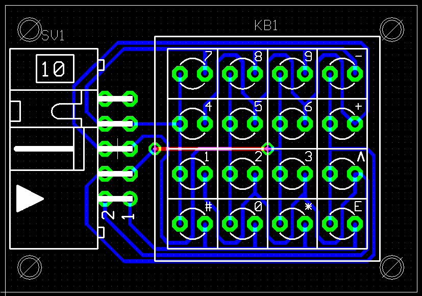

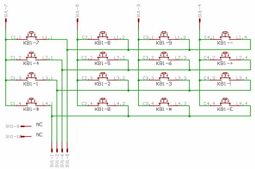

Hi all,
I've now designed a 4X4 key pad wich might be useful with an MCU.
It contains digits 0 through 9 plus function keys "+", "-", "preveous", "#", "*" and "E" for Enter.
Each single key might be placed anywhere in the schematic design for shortest net routing.
The pins are labelled in a logical order, so connecting the single keys to a matrix should not constitute any problem.
Each single is identified by its function, e.g. "5" has the label KB-5 and additionally pin information C2,2 and L2,2, meaning it is the second key of the second column and the second in a row.
Connecting the keys simply connect each key starting with the same pad number, C1,1 through C1,4 connect to net column1 and e.g. L3,1 trough L3,4 connect to net line 3.
Any suggestions for improvement?
Hans
