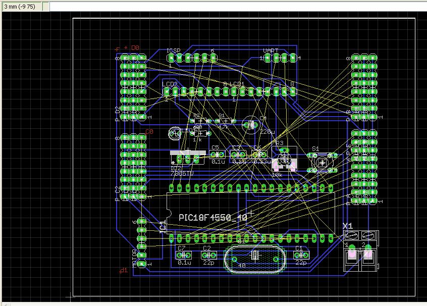

I'm making a PIC development board and need your help.
i made the schematic,and kind a stuck with routing it.auto router isnt doing goodjob of routing it.
can some one give me a hand here? (this is the first time i'm using eagle cad)
i have attached relevent files here.

Auto router will give you the nearest possible as much it can.The other balance you must do by using the router tool.
When I'm doing a PCB I won't auto route.I draw the schematic & click the board icon so you get the ratnest.After I place components to the best place where it minimizes jumpers & overlapping lines.Finally I'm routing manually by the use of route tool.
Hi aruna1,
you're making your life tough using a grid size of 3mm for the PCB layout.
Most parts are manufactured using imperial measurement. Using a metric scale routing becomes extremely difficult and ends in a never stopping "angle" and "overlap" error list when performing a DRC.
I suggest to delete the PCB and create a new one. Use a grid size of inches and a fraction thereof. If you're used to metric scaling use the windows calculator to define the grid size in mm instead of inches.
1 inch equals 25.4mm, 1/2 inch=12.7mm, 1/4 inch=6.35mm etc. Using the equivalent metric value traces will be straight from pin to pin. Otherwise the router has to jump to "snap" and makes funny bends.
Ratsnesting your designed PCB there are lots of crossing airwires, meaning routing will become almost impossible unless you use multilayer.
If you must do that because of a prescribed position of connectors you should really think about a multilayer board design.
Boncuk
P.S. No wonder the file size of the zip file was very large. You also zipped the backup files!

hi i didn't get what you said,can you explain little bit more

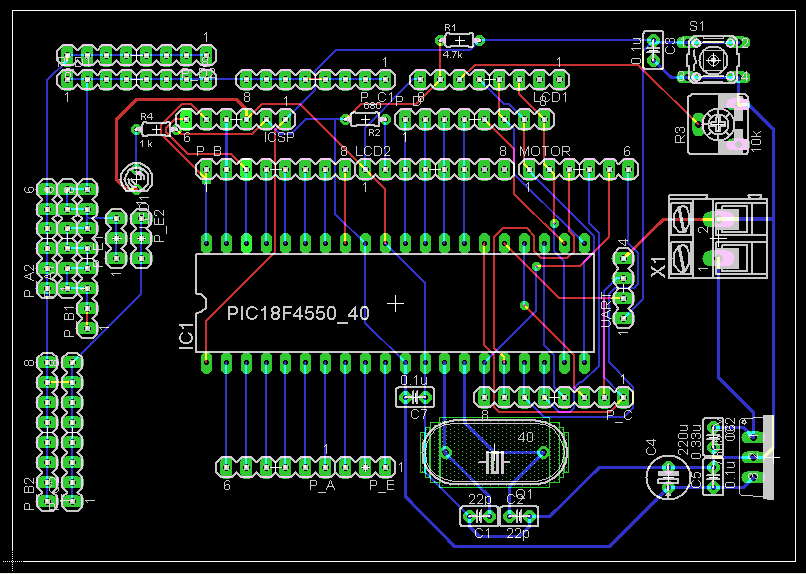

Hi arun1,
here is a screenshot of your original PCB layout.
Notice the grid size in the upper left hand corner.
It says clearly "3mm". With that grid size you don't do yourself any favour.
Delete the board and create a new one.
That's the best advise I can give you. Also place the connectors close to the MCU-pins for easy routing.
Rearranging MCU pin connections and connectors the PCB can be made single sided.
The screenshot shows you the rough board design with the pins connected as per your schematic.
One word referring to schematics: It's no good practice to draw nets through the outline of an IC. Pin names become unreadable and the overall picture makes a bad impression.
If you don't have enough space to design on A4-format use A3. When printing use scale factor 0.7 for a format filling A4 paper sheet.
Boncuk

@Boncuk, Nice workout !!
t looks much simpler in its new component overlay.
Hi mvs,
thanks for the flowers. :)
If the OP decides to connect MCU and connector pins in an altered (and logical) sequence he can shrink the PCB a bit more. That "design" took me 20 minutes with the board size shrunk 20mm in height.
