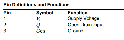

I found this https://www.is-beer-a-vegetable.com...Handheld_vacuum-_cuts_out_after_a_few_seconds which advocates removing this hall effect sensor ( TLE 4913 ) and bridging contacts 1 & 3. I've done this but nothing doing .. .. however, the datasheet for the TLE4913
**broken link removed** states that pin 1 is Gnd; pin 2 is input; pin 3 is output; That being the case, then bridging pin 1 & 3 is putting output to Gnd, but if there is no input - no output ? Right ?
I'm tempted to bridge pin 2 & 3 - input to output but I don't know that the voltages match .. .. .

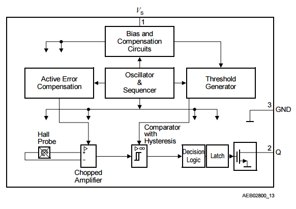

If you remove the sensor and bridge 1 and 2 that should set 2 High.[ if you are of a nervous disposition, you could use say 100R for the link
Don't short 1 and 3 as the d/s suggests that you will short out the Vs supply

As the output pin 2 is open drain, its possible that the output is active low, shorting to 2 to 3 should do it.

I'm looking in the datasheet and it does not show the pinout you mention:
The output is open-drain, meaning that when the device is "active", the output transistor connects the output to ground. Whether "active" means the vacuum is "on" or "off" I couldn't tell you without seeing a schematic. If you want it to permanently be "active", you need to short pins 2 and 3 together, but again, it depends on what it's "normal" state is.

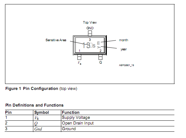

The output is open-drain, meaning that when the device is "active", the output transistor connects the output to ground. If you want it to permanently be "active", you need to short pins 2 and 3 together.
That would only be correct if the sensor is in place ???? If it is removed .. .. it would be 1 & 2 ?
S
S

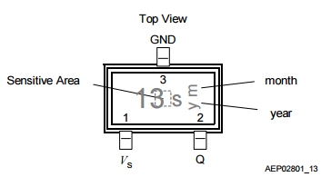

It would either be shorting 2 and 3 together, or leaving the output floating. I doubt it's the latter.
Also, please note that the numbers shown in the drawing you linked to ARE NOT the actual pin numbers! Linking PINS 2 and 3 together is the same as linking POINTS 1 and 3 on this drawing:
hi S.
It is IMPORTANT that the IC be removed before adding any links.:woot:

I have tried with all 3 combinations .. .. IC on it's own; IC removed and link in place; IC in place and link ; None of those combinations make any difference at all.
