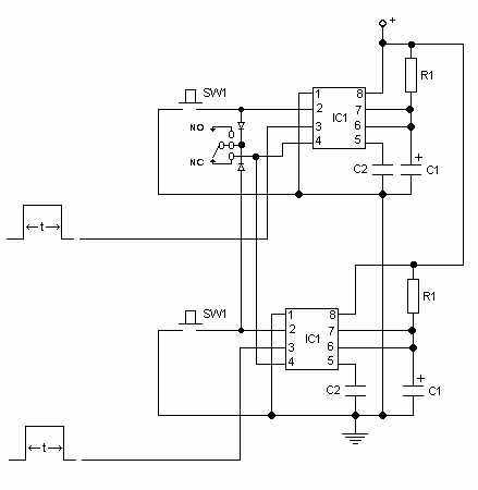

My first project which I'm learning basic electrics with.
I'm still awaiting my delivery for parts hence I cant test this.
plus I'm sure you guys will be able to tell me where I'm going wrong by just looking at it instead of me frying it then realising 'oh yea'
This is the final schematics for having a dual timed monostable set up with either button to reset the 555 while on a monostable run.
in this set up the output can be motor, LED's or a bleeper.
Can you guys tell me if I've gone wrong anywhere or will this work.

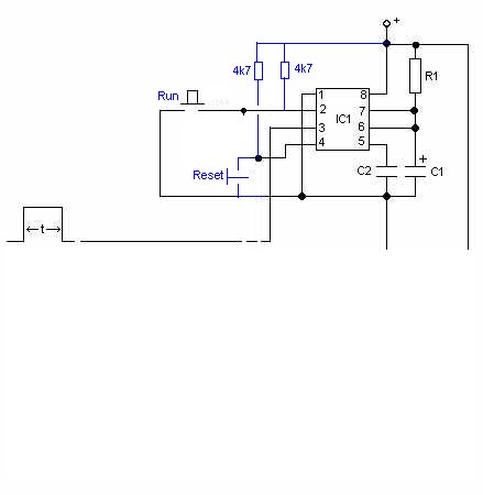

There are a number of problems with your posted circuit.
Pin #2, the Trigger has to be connected to +V , via a resistor, say 4k7.
Each pin2 must have its own resistor to +V
What is the purpose of the change over switch and diodes.???
The easist solution to Reset either 555 mono, would be to connect pin 4 to +V via a 4k7 resistor and use a push switch to pull pin 4 to 0V.. Each pin4 must have its own resistor and push switch
The change over switch (SPNO relay) is to stop the any power going into PIN4 which resets the timer no matter what state its in (In this case I would like to stop the monostable output using wither of the button)
I guess I put the diode in there so that the power does not run from the tops circuit to the bottom (to create a one way current flow into the relay only) If I'm correct, without the diode the switch could potentially set both of the 555's off? I think i may have forgotten to add a few more components like resistors and grounding the 'NO' terminal.
Sorry I am still learning, It's only been a week :p please do advise me

Look at this image, it shows one 555, but both circuits will be identical.
One switch for Run, one for Reset.
OK.?

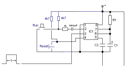

Rc ramp added according to the site I copied it from it will give an approximate 1second delay?
so the Rc will only go to trigger and won't affect PIN 4

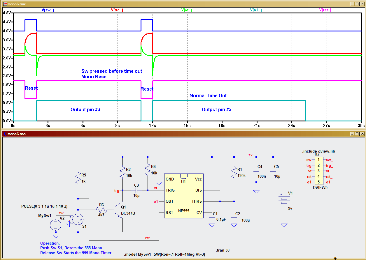

The circuit as copied from the linked site will not work as you have drawn it.
Can you post a link to the site where you copied it from.?
This circuit will do want you want.
1. Press Switch , resets the 555
2. Release Switch, 555 timer starts
3. Pressing again BEFORE time out period ends will reset the 555
4. Normal time out period, if Switch not pressed during timing.
Adjust value of R1 timing resistor to get the required mono timing period.

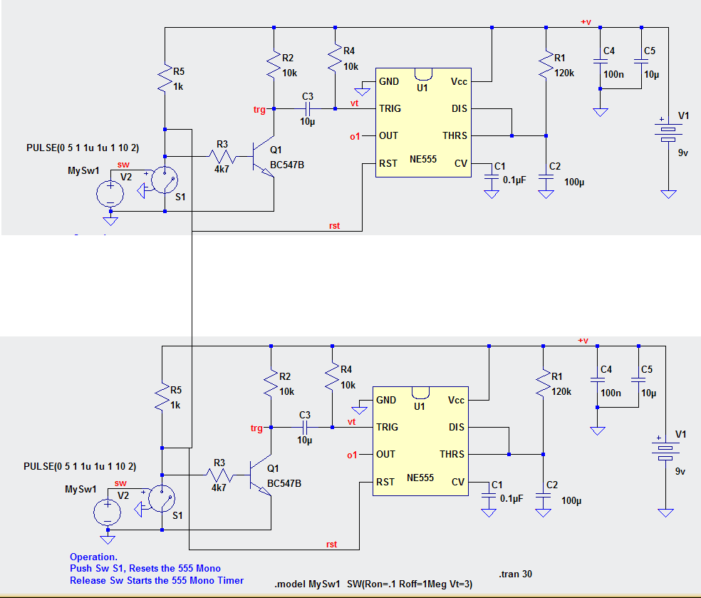

If just connect the two circuits together as you have shown, every time you push either switch, both timers will Reset, when either switch is released both will start running.

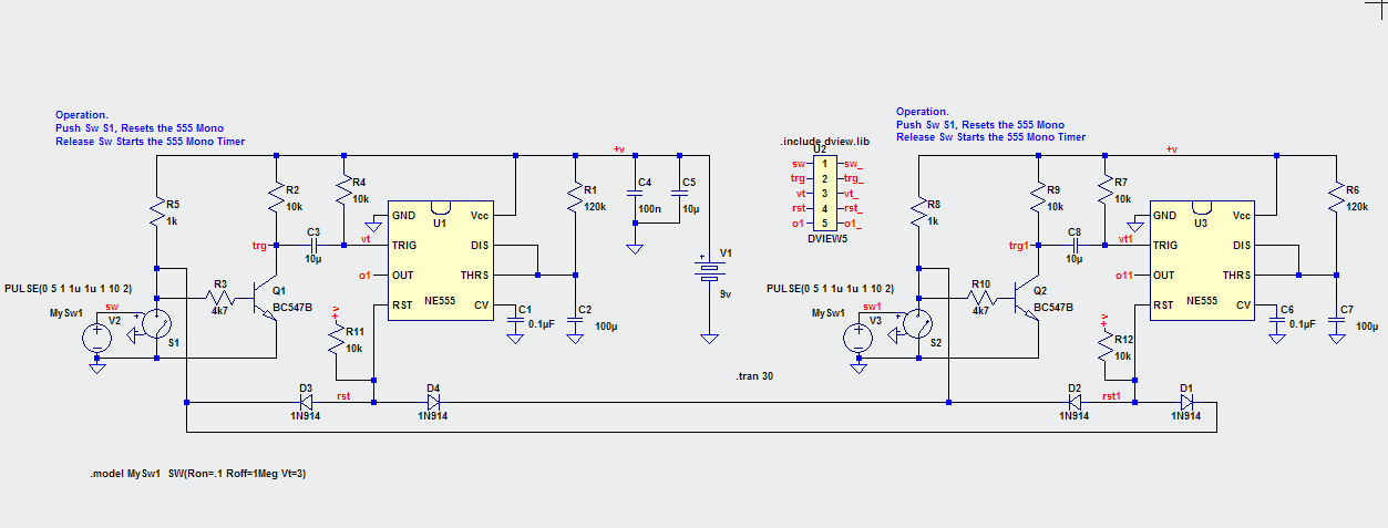

Look at this option.
I dont understand why you dont want to use a separate Start/ Reset for each circuit.??

Just to make sure. C3 will cause a delay to the start up of the timer by 1 second correct??
ericgibbs - Thanks for that. I mean having two totally separate circuits is not a big deal. I just like to create something just the way I see/want it. It creates a challenge sometimes which I enjoy.
Does your circuit complete my dream :p? Thanks
What I wanted was I press and hold the switch for 1second
the monostable starts and runs for 10seconds
If for any reason I wanted to stop the monostable run, I would press the same button again.
I want the reset to be instant but the normal out pur to have the 1 sec delay.
That's what I am trying to make.
Can I not just add an RC ramp to trigger??
And does it matter which watts resistor I use?
