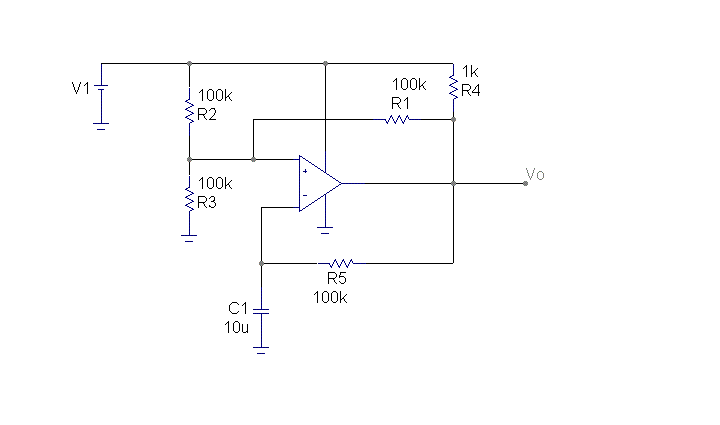

I have 10 cmos 4013 dual d flipflops, quad op amp 33174p,4011 quad nand, 4049 hex inverter,cd4017 decade counter,cd4018 divide by n counter, and most all discrete components also 10 npn transistors, 4023 3 input nand,4066 quad switch, think with these maybe I can fashion a low speed clock.
I think you can use your op amp for this circuit. You can vary the cap and/or R5 to change the frequency.
Using the 4049 inverter you might use the cap and resistor alone.
In any case you might want to use a FF on the output to square up the wave and make it 50 percent duty cycle.

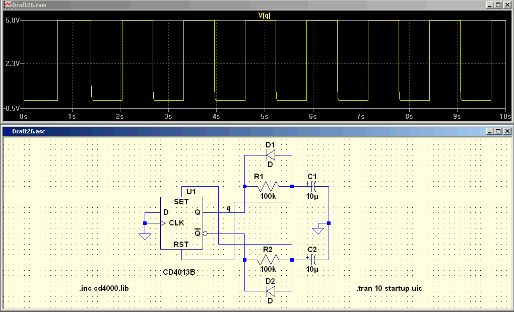

.... or you could try this:
That's nice, but would you seriously use two capacitors and two resistors and two diodes and a flip flop rather than one cap and one resistor and either a single NAND gate, NOR gate, or inverter, or even single comparator or op amp?
Personally, I wouldn't. But the OP wanted to use a D-flop. The thread title gives a bit of a clue :)
thank you for all your input,, I made the one op amp changed the 10 uf to a 1uf and gated the out through an inverter on 4049, 2working super.... just right speed for me to visualize the functions and adjust gating accordingly.. a simple but effective solution, very much appreciated!!
