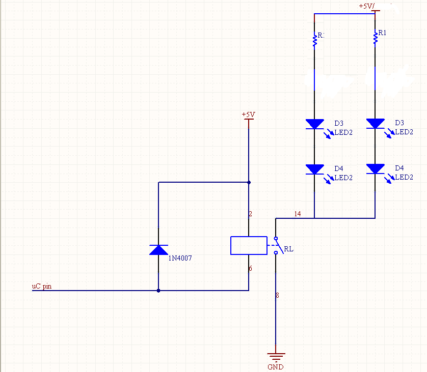

i need to drive a couple of LEDs (8 or 10 of em) using a relay form a uC pin. can someone suggest a circuit configuration/drawing. i have DIP05-1A72-12L from MEder Electronic.
kind regards

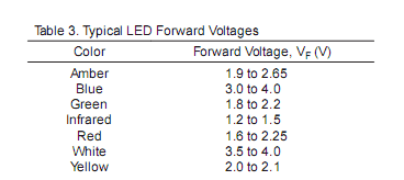

What colour and forward voltage drop are the LED's.?
I assume they are the 15mA to 20mA type.
they are the typical green and red ones, i normally use 220ohm if i have to connect it directly to my uC.
Reason for asking, is the difference in Vfwd. Look at the image.

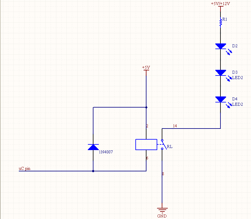

You can connect LED's in series and use a single resistor.
Say you have a +12Vsupply, you could connect 4 or 5 Red LED's in series and choose a resistor to allow 15mA thru the LED's.
If You only have a +5V supply, connect 2 Red LED's in series with a series resistor.
The relay coil [from the other post] has a 500R coil, so it can be connected to the PIC output pin.
Does this cover your question.?:)

am i correct?

am i correct?
Looks OK, if its 5V and the Red LED's drop say 2V each, you can only have 2 LED's in series.
[ 2 * 2=4v] leaving 1 volt to drop with the resistor.
If its 12V and the Red LED's drop 2V each then you could have 5 LED's in series [thats 5 *2 = 10v]
and use a series resistir to drop the remaining 2Volts.
If the LED's are 15mA, then the resistor would be Rs= 2/0.015 = 133R say 120R.

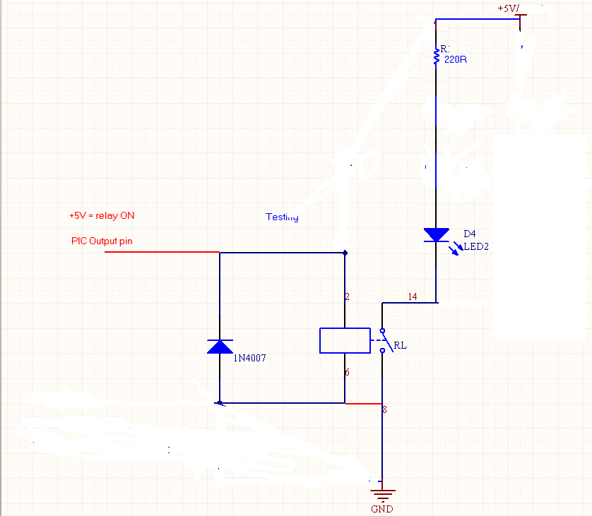

i'm trying to test it but with no luck. i'm using 5v with 1 LED and 220ohm. what might be the problem now?
A number of reasons.
First test the LED by using the 220R in series and connect across the 5V.
The LED should light, remember the cathode of the LED goes to 0V.
If that works OK, then connect the the LED and resistor to the relay as per you drawing. using pins 14 and 8
If the LED dosn't light you may have a defective LED or the 220R isnt a 220R but some higher value.!

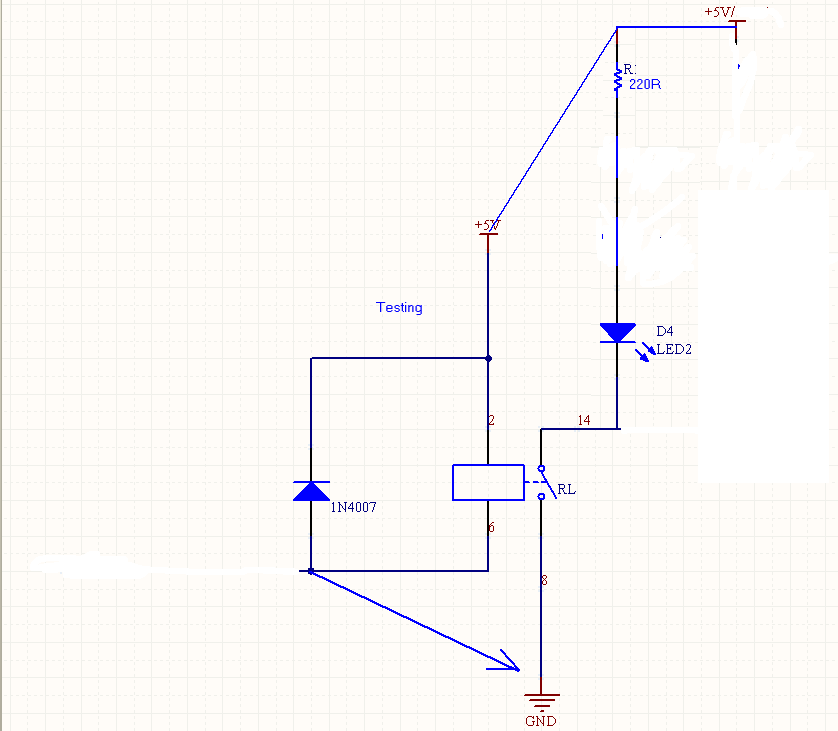

Connect +5V to pin 2 of the relay coil and the 0V to pin 6 of the relay.
When you do that the relay should operate, you may hear the relay click over and the LED should light.
EDIT: you do these tests with the relay and LED's, NOT connected to the PIC

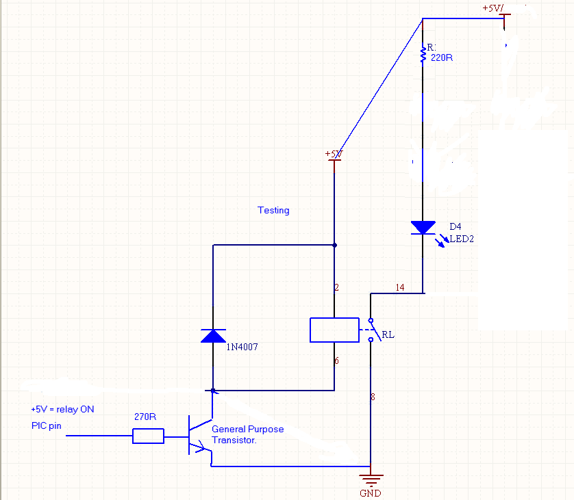

following the above instructions, everything works fine...then where do i connect uC pin. pin 6?
again, will the relay switch when i send logic ZERO from the uC?
Thats good.
Connect pin 6 of the relay to an OUTPUT pin of the PIC.
In the program you must configure the PIC pin as an output.
Which PIC are you using, can you post a program.?
EDIT:
If you want to add a transistor driver for the relay, see the image.
With the relay connected to the PIC pin without a transistor, when the PIC powers up, the relay will switch ON, until you make the pin high.
Using a transistor OR by connecting pin 2 of the relay to the PIC output pin and pin 6 of the relay to 0V, will mean the relay will not operate until you set the PIC pin high....OK.
NOTE:
You cannot always connect a relay coil directly to a PIC pin.
As your relay is 5Vdc and is 500R, that is 10mA its OK.

yes, relays/LEDs are working. by connecting Pin 2 to +5V and pin 6 to the uC pin, one need to send logic Zero from uc pin to switch the relay ON and vise versa.

Morning Mike,
Repost of the way the DIL 5V relay is connected, the pin # are the relay.
Personally I would have just used a transistor to drive the LED's.
