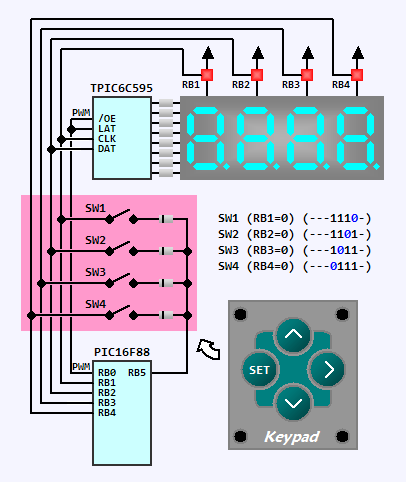

As the guys have mentioned, once you've decided to add a chip, there's lots of design choices. Here's yet another example to throw into the mix;

Another option to consider is to use an 8-bit shift register (like the 74HC595) to connect to the 8 segments, and drive the common cathode/anode pin using a transistor. This will require 6 pins, 3 for the shift register and 4 for the digits.

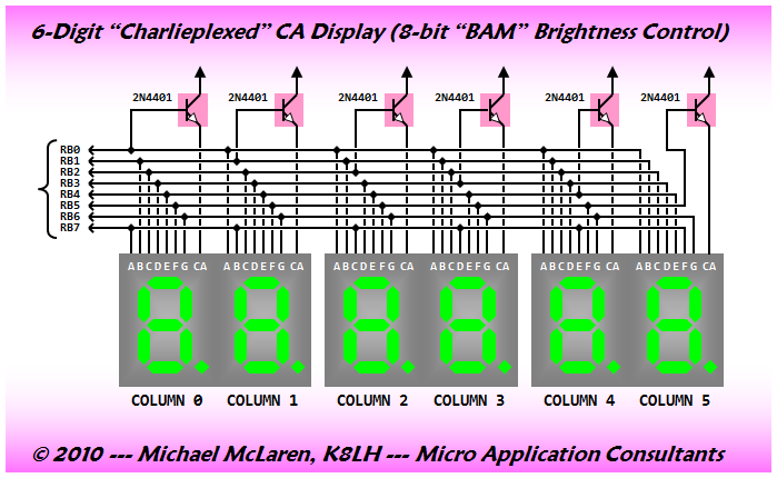

If board space is tight and you don't have room for an extra chip, you might consider Charlieplexing the display. The "up side" is you only need eight (8) pins and you should get the same brightness and performance you're getting now (with direct segment drive). The "down side" is the funky display wiring.
Regards, Mike

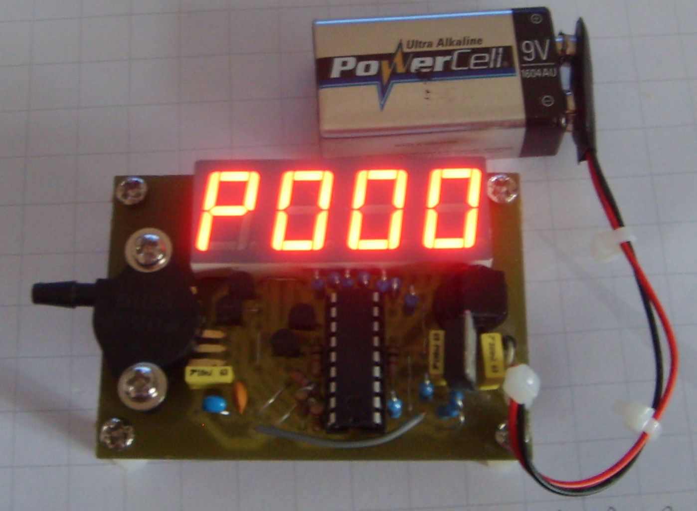

The last project I used a 4x7seg display and switched each digit on/off with NPN transistors and drove each segment directly (via resistors) from the PIC. On a side note, I used PIC16F88. See image below.
This is an older one I did some time ago. As you can see, the board's getting pretty cramped. Although I was fairly happy with the current usage (overall about 70mA including running the sensor on the board). And it was quite an effective little unit.

It's a small display. Actually, the board size limitations are a mere 20x45mm! This is just about enough space to fit the 3x7seg display, plus a PIC16F88 (SOIC package).
If I can use both sides of the board, I should be able to fit the remaining components (reg, caps, transistors, resistors etc).
Adding another PIC would be great, although I'm not sure I'd have enough board space to accommodate both PICs. I like the idea of the 74HC595 though. Looks very compact.
Another question - I've seen some projects where the LED/segments have been driven directly from the PIC (with no resistors) and reduced using PWM. If the overall current consumption is within the PIC's limitations, is this ok to do? Or should I just steer clear from this method altogether?

Looks like you're making a pressure gauge of some sort. That's a motorola sensor there.
