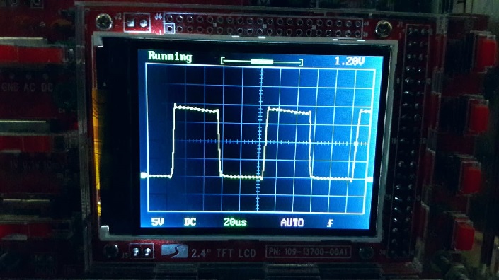

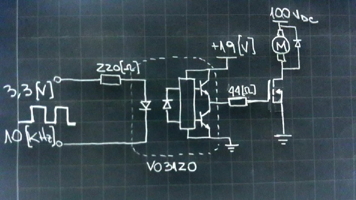

Hello friends, it's me again. Finally I was able to get the VO3120 that can deliver up to 2.5 A at its output. I have connected the "free" motor (motor without load, approx. 300mA), as shown. Also change the power for the driver, now 19V (since the driver would not work with 12V). The voltage at the FET gate (irf640) is as shown in the figure. Everything looks great, except that at 30 seconds the mosfet overheats to burn. I have added a small heatsink, but also heats up excessively. Some people recommended to check the bootstrap topology, but I think that in this case it does not apply. Any suggestion is welcome. Greetings and thanks.
The LED drive current must be a minimum of 7mA to guarantee proper operation, according to the data sheet.
Are you getting that with the 220 Ohm series resistor and only 3.3V possible drive voltage?
..... also,
a) 19V is perilously close to the 20V Absolute Maximum rating for Vgs of the IRF640,
b) The on resistance of that FET is 0.18 Ohms, the starting current of the motor will be a lot more than 300mA, and so you can expect some heating of the FET.
c) Unless the gate resistor is right at the gate and there is only a very short wire between the driver and the FET it is possible the FET is oscillating.
Another thought - is the diode across the motor a fast-recovery or schottky type?
Normal rectifiers line 1N 4000 or 1N5400 series are not fast enough to work with PWM systems, the turn on & turn off times are rather slow.
Also depending on the characteristics of the motor, a small inductor in series near the FET drain may improve switching.
The voltage at R1 is approximately 2.1 V during the high pulse. With the R = 220 ohm, the current should be about 9.5 mA (7 - 16 mA according to data).

a) You are right about the maximum limit, Im working very close of it, however Im feeding with a laptop source, with a fairly stable output of 19.3 V. It has never exceeded 20 V. Also, the FET overheated when Vgs was near of 12V.
b) Like you said, the 0.18 ohm and the 0.3 A max RMS that Im measuring with the clamp generates 16.2 mW. Im sure my FET is dissipating more power than that, because it heats up to melt.
c) The resistor of the Gate is actually right next to the MOSFET pin, but I must mention that I have mounted the circuit on a breadboard, and I must be honest that the phenomenon of the oscillation was unknown. I will investigate on this point, thank you very much for mentioning it.

The diode I am using is a RU1A, according to data it is a fast recovery diode, 5kHz tests are suggested according to its datasheet.

That's what I was getting at; the LED will have a voltage drop of 1.8V (or possibly rather more), leaving just 0.3V across the resistor.
That's about 1.4mA current at most.
You need at least 1.6V across the resistor itself to pass the 7mA threshold; that's just a bit difficult with a 3.3V signal less a LED voltage drop of around 2V.
You may need to drive the base or gate of a switching transistor and connect the opto and its resistor to power instead, switching the low side.

I think there is a misunderstanding, The voltage across R1 is 2.1 V during the high pulse, and across the diode the voltage is 1.2 V approximately also in the high pulse.
By adding both voltages, the 3.3 V is obtained during the high pulse, all this measured with the oscilloscope. Excuse me if my English is not very good. Best regards, colleagues.
