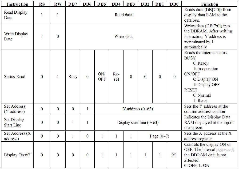

Hello, i want to drive a 128x64 lcd display in assembler (i have wg12864 lcd)
I'm not able to use correctly enable..
i found documents like the attached one, but i haven't exaustive information about enable...
for example... seeing the attachment i understand that...
1) i have to turn on the lcd (clear RS, RW, DB7, DB6 and set DB5, DB4, DB3, DB2, DB1, DB0)
2) set Y (clear RS, RW, DB7, set DB6 and use DB5, DB4, DB3, DB2, DB1, DB0 to indicate Y)
3) set display start line (clear RS, RW, set DB7, DB6 and use DB5, DB4, DB3, DB2, DB1, DB0 to indicate the start line)
4) set X page (clear RS, RW, DB6, set DB7, DB5, DB4, DB3 and use DB2, DB1, DB0 to indicate X)
5) write data in ram (set RS, clear RW and use DB7, DB6 ... DB0 for data)
Is it correct?
I have to turn on the lcd as first operation or after the write ram process?
I have also to select left o right zone with CS1 and CS2, it's sufficient before writing data in ram?
and what about enable signal???
i'm trying with a 16F886 but i'm not able to control the display.
Thank you!

Here is the sequence I use to init my GLCD in asm.
InitLCD_1	bsf	b_LCD_CS1
		bsf	b_LCD_CS2
		movlw	0x3f
		call	WriteCMD
		movlw	0xc0
		call	WriteCMD
		movlw	0x40
		call	WriteCMD
		movlw	0xb8
		call	WriteCMD
It's a little tricky as this is part of a huge project but here are WriteCmd and WriteData.
WriteCMD	movwf	LCDTemp
		call	WaitNotBusy
		movfw	LCDTemp
		movwf	PORTB
		bcf	b_LCD_RW
		bcf	b_LCD_RS
		bsf	b_LCD_E
		bcf	b_LCD_E
		return
WriteData	movwf	LCDTemp
		call	WaitNotBusy
		movfw	LCDTemp
		btfsc	b_Inverted
		xorlw	0xff
		movwf	PORTB
		bcf	b_LCD_RW
		bsf	b_LCD_RS	;rs=1 rw=0
		bsf	b_LCD_E
		bcf	b_LCD_E
		return
