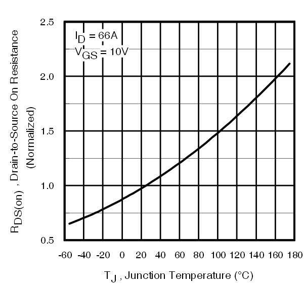

You cannot connect transistors or Mosfets directly in parallel to increase the current handling because they will not be exactly the same. The more sensitive one will take most or all of the load current and be destroyed.
Yes and no.
We are talking MOSFETS.
The IRF3205 has a typical resistance of 4.9m ohm and a max of 6.5m ohm. If a typical and a max part are parallel, yes they don't share equal but one will not take all the current!
Look at the graph below. If one part takes more current it will heat more. This heat will cause the RDSon to climb. This will shift the current more to the other part.
The parts will never share equally but they will share.
I wanted to point out that you cannot buy matched transistors or Mosfets. Although the OP was confusing voltage with current, he talked about doubling the load on the Mosfets.
If typical and max RDSon Mosfets are paralleled then the one with the lowest resistance takes more current, gets hotter and burns out first. Then the other Mosfet becomes overloaded and also burns out soon.
Talking slightly off topic here, but you can parallel MOSFETs if you are driving them hard on (like in a switched mode power supply). If you are driving them in their Ohmic region (between fully off and fully on) then they do not share current very well. Differences in VGS threshold alone can ensure that one FET takes all the current while the other is nearly off. Also, the tempco is only positive when in the fully enhanced region enabling a level of thermal regulation, but not so in the Ohmic region.
AND, the channel resistance of a MOSFET has a positive temperature coefficient, so as one FET carries more current than the other, it heats up more and it's Rds increases, decreasing its current. Not enough to balance the load sharing, but better than nothing and way better than bipolars.
