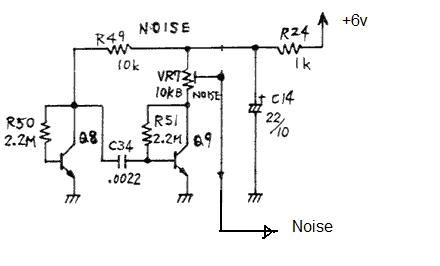

I built the noise section of the DR-55 drum machine. It is generating noise (white noise which is OK) along a hum sound which I don't understand where it comes from since I am using batteries (6v) . I am connecting the output to a set of computer speakers that are AC powered (could this be the source of the hum noise?). How do I get rid of the hum noise? Also can you please tell me what is a 22/10 capacitor ? I try various values in the circuit but none get rid of the hum noise.

A 22/10 is a 22uF at 10V working voltage
How is the Noise Gen connected to the main amplifier and which point on the main amp ground/0V line is the Noise Gen battery -V connected.
It sounds like a 'ground loop' problem.
Thanks a lot for the interest - I connect the negative of the battery to the negative side of the plug . The output is the tip of the connector to the amp.

Try AC coupling the noise generator to the sound card's input?
If there is hum when the battery is disconnected from the noise circuit then the cable from it to the amplifier has poor shielding.
If the noise circuit is built on a breadboard then long wires on it are antennas for picking up mains hum.
Maybe the ground connection in the cable from the circuit to the amplifier is broken.

Hum is not present when the battery is disconnected. It occurs when the circuit is power up. Yes it is on a breadboard the only long cables are the Amplifier/Speaker cables. White Noise and hum are generated at the same time. If I touch both ends of the capacitor the hum is reduce considerably....Maybe a resistor in parallel with the capacitor will fix it...but anyway why does it produce hum?
If the circuit is made on a compact pcb or stripboard then it won't pickup the mains hum that the wiring of the breadboard circuit picks up.
Each row of contacts on a breadboard and each wire are antennas that pickup mains hum.

That quite interesting. Is there a way to shield the circuit from the mains? I have not finished it yet.
If the breadboard has a metal base, connect that to circuit ground or 0V. It may help a little (or a lot).
ok. I don't have the hum noise problem. Thanks a lot. Now....how do I buit an amplifier suitable for this circuit. I will like to built one using an LM324 OpAmp. Any suggestion?
