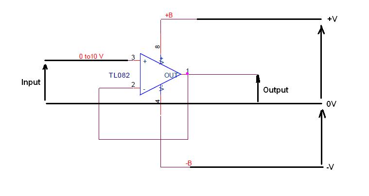

I tried an opamp (TL082) as a buffer stage (output pin connected to negative input ). When I gave +15 and -15 supply and varied the positive input from 0 to 10 V, the output was not going above 9.4V. But when I connected GND to - supply point (instead of -15V) I got 10V output for 10V input. Why does this happen?

Here +15V and -12V supplies are given to the OpAmp. The source has 0-10V variation with respect to its GND. This GND is not directly connected to any of the OpAmp pins as there is no GND pin for it. Is this OK?
Just to remove any ambiguity, make sure that it is connected like this:

Make sure that the supplies are well decoupled to ensure that the opamp is not oscillating.
Thank you for the reply. I think, oscillation is the reason. I can see oscillation in the output beyond certain input level (checked with oscilloscope). Where can I get more information on the probable reason and solution for such problems?
