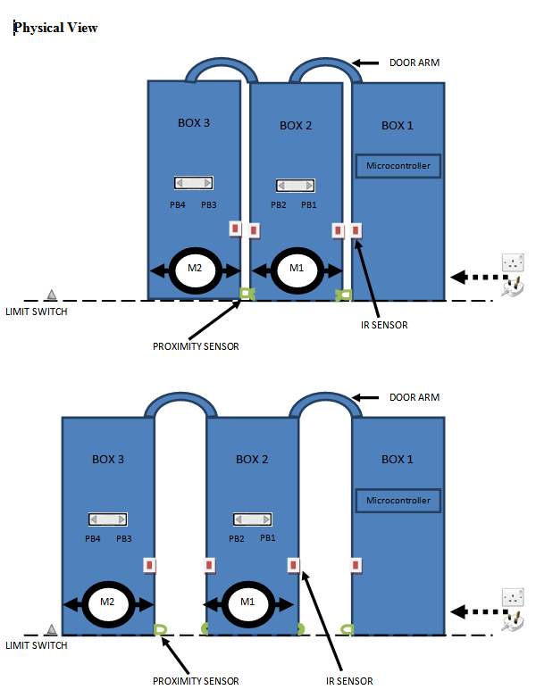

Hi everyone,
I want to apply the soft stop technology in my project by using PWM, and PIC16F877A.
It mean I want to control the closing door box to a smooth impact.
But I am lack of C but I am trying to learn it.
Attached here is the model of my project.
Here is my MicroC code. Still under construction,only have a basic movement.

My problem is when i simulate using ISIS proteus, the motor run without selected any button.
System Operation
Here are 3 boxes of cabinet. Box 1 is fixed box while another 2 boxes is moveable box. The user can select either PB1 or PB3 “Right Button” or PB2 OR PB 4 “Left Button” at any box. For example; if the users select the PB2 of box 2, both motor (M1 and M2) will run to left side until the motor 1 detect the proximity sensor and motor 2 reached a limit switch. When the user step in the aisle between the box 2 and box 1, the both motor will stop since the PIR sensor will automatically detect the user. So, automatically whole the system operation will stop and all illuminated push button will blink. When the sensors clear the interrupt (no obstacle), the user can continue the current operation by select either “Right Button” or “Left Button” at any box again. IR sensor used to detect user and Proximity sensor used to keep the safe distance between tow boxes.
