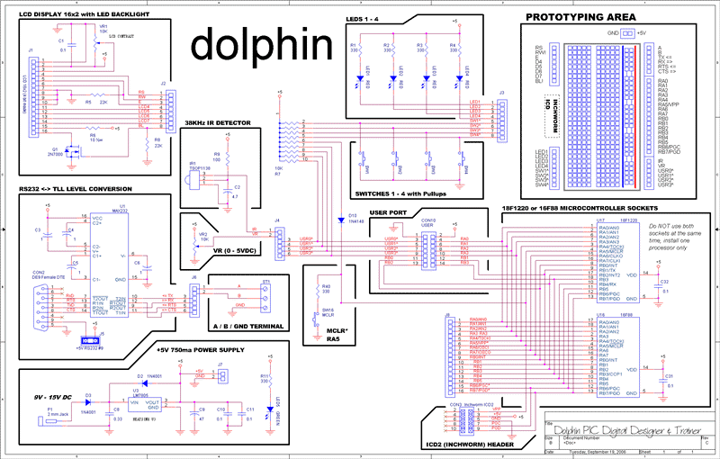

Dolphin 16F88 / 18F1220 Designer Schematic BETA
Here's the current BETA schematic for my Dolphin 16F88 / 18F1220 Designer & Trainer.
  • It uses a 350 hole solderless breadboard.
  • 16x2 backlit LCD display
  • RS232 with level converters
  • IR TSOP1138
  • 10K POT
  • 5V 500ma Power Supply
  • Sockets for either 16F88 or 18F1220
  • 4 LEDs
  • 4 Switches with pullups
  • ICD2 / Inchworm connector
  • User expansion plug
  • A / B / GND Screw terminal
Take a look, I'm working on the PCBs now. Looking forward to making a project book with it. There is an incredible amount of things you can do with a PIC and a few LEDs / Switches... :)
Sorry it's a lowres picture. When it's complete I'll post a mich nicer one.
Comments welcome.
