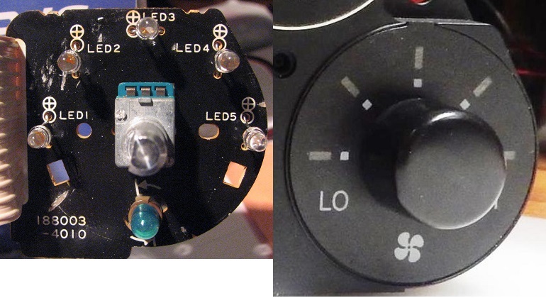

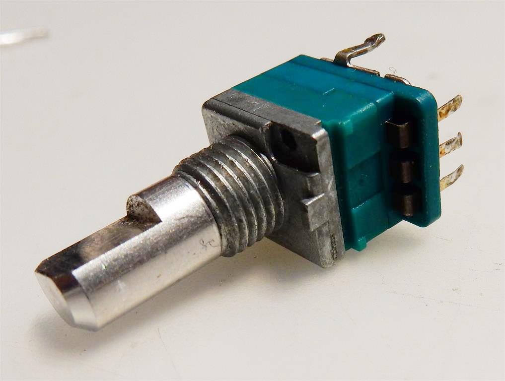

I am trying to source a similar platform rotary switch with no luck. Turning either direction is a momentary grounding connection. I made a test set up with 2 push button momentary switches and the results worked. It has to be this type of rotary to fit into the existing circuit board.
I have exhausted searching on Mouser and Digikey and I cannot find rotary style momentary with continuous indents. I have tried Encoders and they do not work in this application. Turning clockwise sends a grounding signal to speed up a fan, CCW sends a signal to lower fan speed.
This is the size and shape I am hoping to get close to. Any help on what this maybe called and if there is such a beast. I contacted ALPs in Japan and they do not offer these anymore.
Stu

One problem with replacing that switch is that the pcb holes are not in line with the centerline of the switch body and its mounting bushing. If keeping that arrangement is important, what about a SPDT toggle or rocker switch? Way more reliable than a rotary switch. If you get one with wire-wrap leads, they can be bent in a zig-zag pattern to reach the pcb holes that are not in line with the bushing.
ak
I am somewhat restricted on fitting in a specific area and having anything other than a rotary would not really work.
I will search to see if that place has an ALps where the pins are rotated 90 degrees
