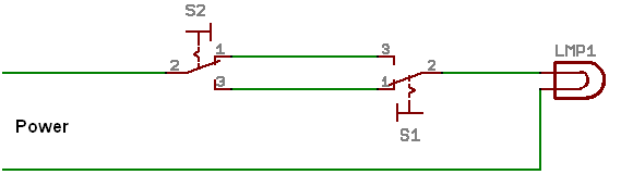

It really depends on how you want it to work. Does the switch have to physically move when the "auto" function activates? If not, you could wire it the same way that it is normally done when you want to control a single light with two switches but just replace one of the switches with a latching relay:
yes, i would like the switch to physically move when the "auto" function activates.
My idea is that there would be two 12 volt dc coils on either side of the switch (just like a relay), and the actual switch has to be able to take 120vac. I would probably interface it to my computer or a microcontroller (yes, 3v0, i still intend to start with uc's, but i have been really busy lately... :))
So in basic terms, i would like an electromagnet to flip a switch on and off. I would also prefer it to be in a professional package... I could make one myself, but that might not be very reliable... that is why i am wondering if there is a such thing on the market...

What might be better is to design something like an electronic light switch/dimmer with two momentary buttons. Then it will be easy to control the lights automatically and the user can also override at will. I don't think you'll find a commercial one where the toggle physically moves by itself.
