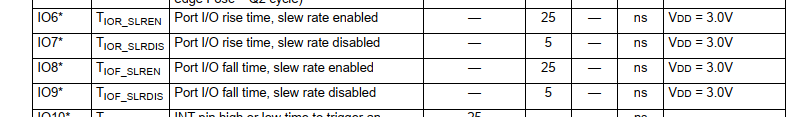

C load, if light, and PCB run to its destination short, should not be a
problem. Does output pin have a speed selection ? Eg. its current capability ?
What is its destination ?
I see this in another datasheet :
Note the NSC ap note on layout target towards switchers, but excellent overall ref on PCB layout.

Many PIC's have a slow slew rate option on the I/O pins, however using it for PWM is a bad idea, as you want the switching device to 'switch' and not work in a linear fashion. Slew limited is usually the default option, so is one of the things you need to disable for most uses - for example leaving it ON severely cripples SPI speed.
But mostly, you're massively over thinking this - just get it built, requirements are really pretty low, just apply a little common sense in your design.
The dimming input to LERD2000 is a logic input, looks to be buffed by its specs.
So PWM slew rate option, if it exist on your specific part, eg my post #4
table of GPIO selection for a generic part, would be fine and lower the
EMI generated by design. PWM input slew rate does not affect your
design switching control of the LED2000.
