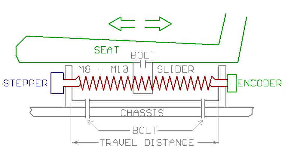

rotary encoders are not expensive at all. Here is one example: "ALPS STEC12E05". It has 24 detents with 24 positions. Cost at Reichelt.de: €2.10 including sales tax. To the UK it's sales tax exempted. (Minimum order value at Reichelt for foreign countries €50.00)
For the mechanical part I suggest to use a threaded shaft (available at home markets in lengths of 1m with M3 to M12 threading) connected to a stepping motor on one side and to the rotary encoder on the opposite side. Let the adjustable part of the seat move using a nut fixed to the seat and have the axle mounted in an angular suspension construction underneath the seat.
Here's a small sketch of the construction principle.
Hans

The Idea of DIY encoders seems to work for me for two of the three motors which have a long worm drive shaft which I could fix a slotted ring to or mark with paint or such.
