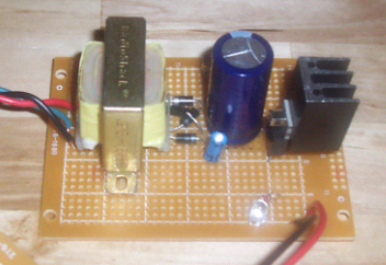

Guillermo, if you are going for the smallest size and weight added to your project, the simplest thing to do would be to use a wall wart transformer, and let the heavy part just rest on the wall while bringing the 12v straight to the circuit.
If you are wanting to not have the big transformer plugged into the wall, and jus want to run a normal skinny power cord to your device, the link I posted in my previous message shows the schematic for using a transformer, bridge rectifier, and regulator to do that. Below is about an actual size picture of one I made to go inside of a project box that can deliver around a third of an amp.
As for current limitations, that cap / voltage divider Guru suggested is going to give very small current. Just the 1M across 12V limits the output to a max of 12mA.

I thought you wanted to make one since you asked for a schematic. :? If you just want to order one pre-made, www.jameco.com is having a special on this little regulated switching dude, search for item 168225, although its a bit long at 9". Perhaps check out their other AC to DC open frame power supplies, Linear or Switching, to see if they might have something else that would better suit your needs, whether based on price or physical size.
