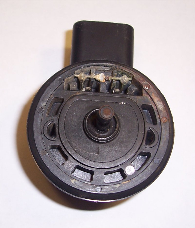

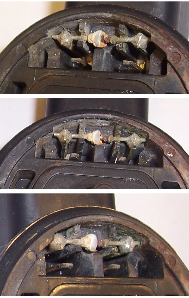

As you can see in the picture I dismantled my valve and found this obvious problem. This part inside, maybe a resistor, a diode or what else, is connected to both pins of the solenoid. The solenoid and the rest of the valve seem to work fine.
If I could find out what is this burn (or broken) part, I would replace it in the hope that it solve my problem. Otherwise, the price of this valve is 178$ plus tax at the dealer.

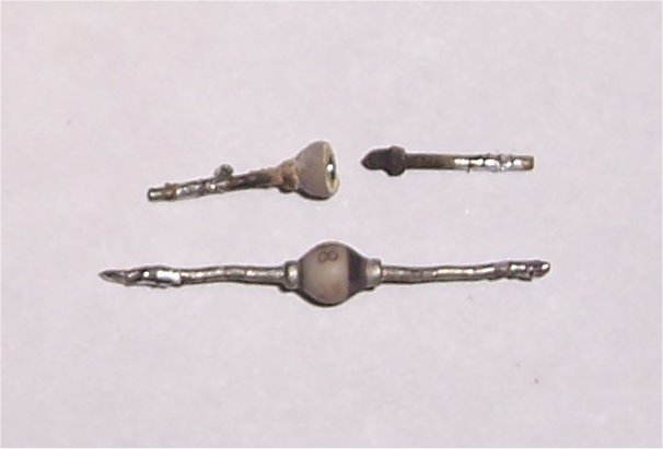

My guess would be the burnt item is a diode, for back-emf suppression. It would be a reverse-biased diode with a current-rating > the solenoid peak current.
Yes, It really look like a diode. This compare to a diode that I have in my part box. The diode number from my box is is 315-6GI818 but I don't find any reference for it.
The solenoid resistance is 8 Ohms. Would you have a part number that I could try?
Alain

Almost anything, including a 1n4001 to 1n4007 is likely to work. It doesn't have to be Schottky or fast-recovery...
Changing the diode with the one that I had got rid of the P0404 for a few days but it came back. The P0406 came back right away.

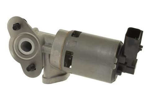

I will order a new EGR valve from rockauto.com along with other parts. The price is really very good compare to the best price that I found locally (125$).
For a total of 115$ CAD this, as I asked them, including shipping, taxes and everything else I will get the better valve plus a set of Champion 7440 spark plugs.

I received the valve and the spark plugs and installed everything. No more code up to now.
The duty and import fees were included in the price. My credit card was charged 118$ CAD, including bank fees.
A total saving of over 50$ for me plus maybe a better valve quality.
