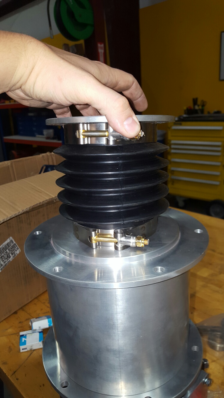

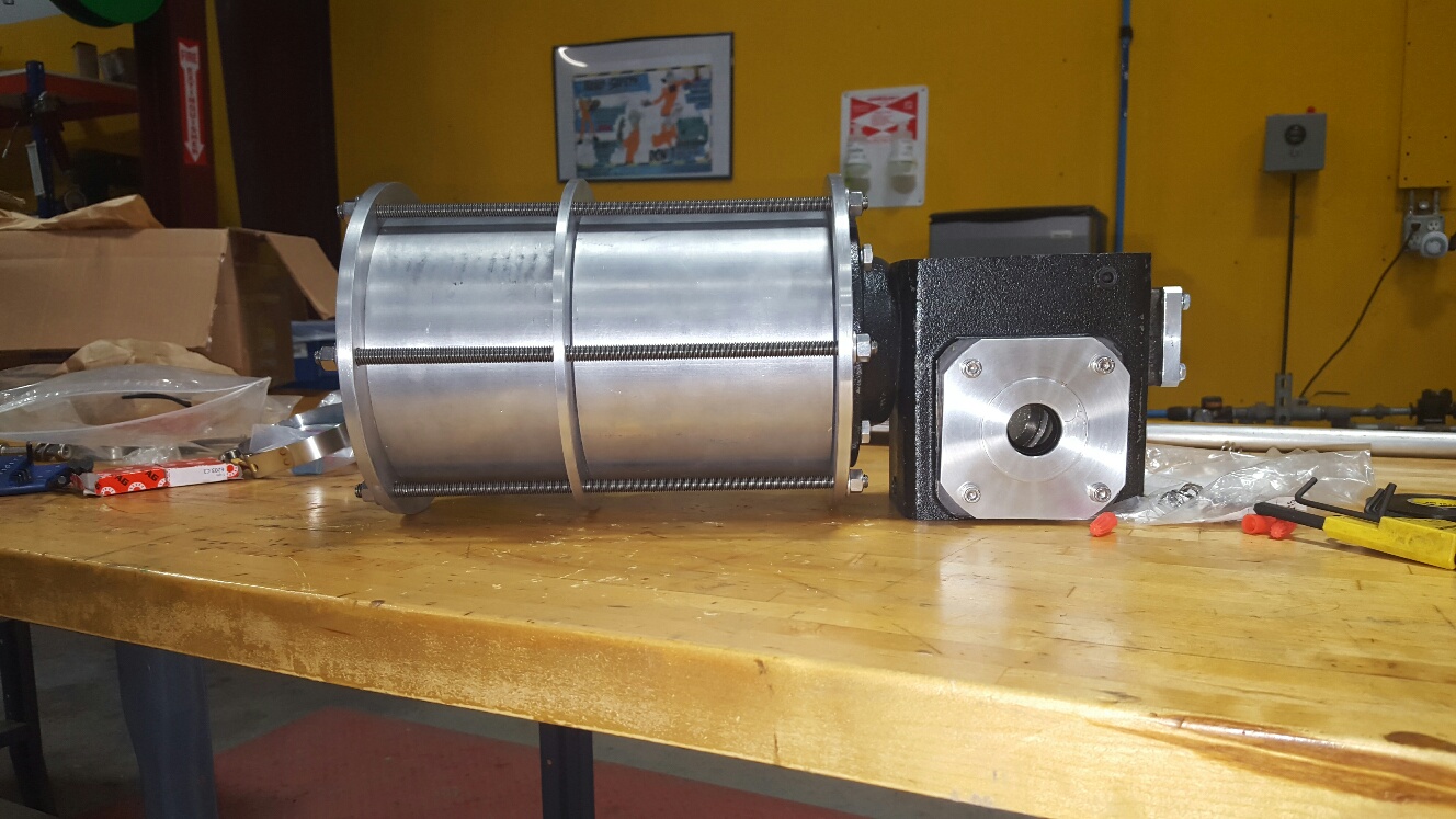

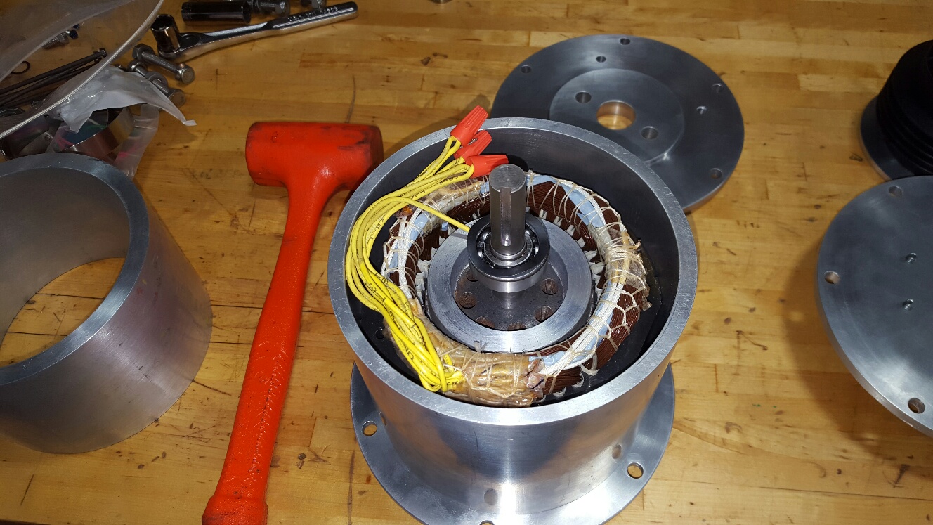

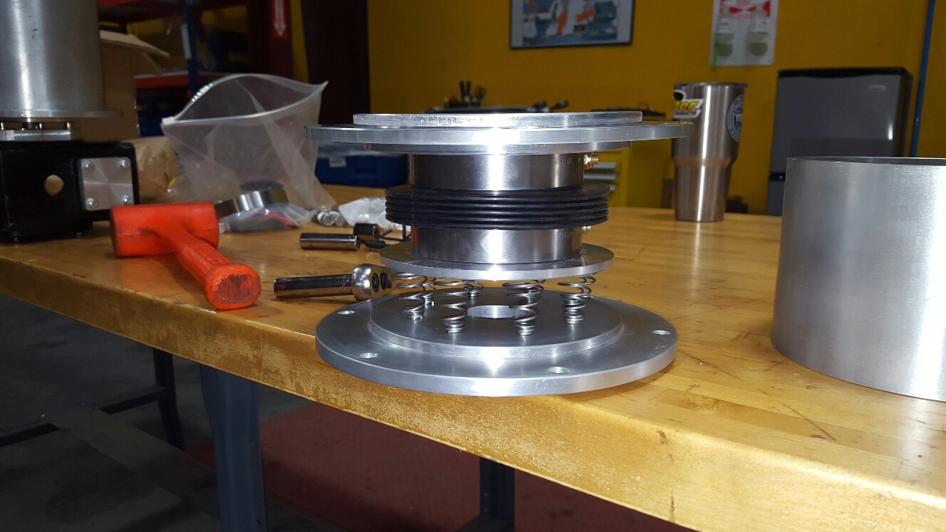

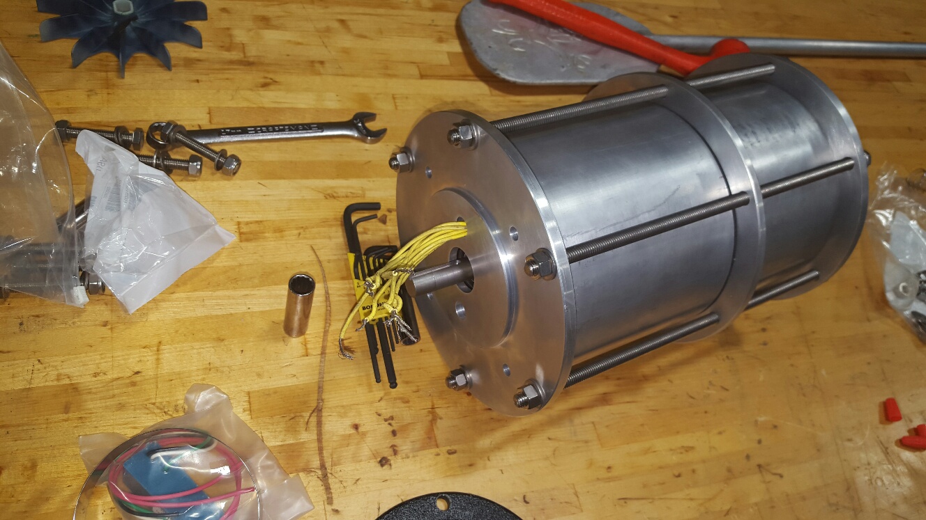

For now, here's the motor I designed, almost assembled enough to test next week.
20160419_091753_resized.jpg 20160419_093258_resized.jpg 20160419_093547_resized.jpg 20160420_074214_resized.jpg 20160420_074655_resized.jpg
Wow, that is awesome, did you do the machine work yourself?
