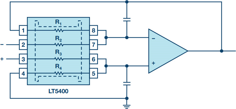

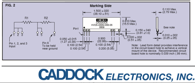

10 M, 2 M, 550 K etc so if a I can get this values encapsulated in Single Chip
You can but it will cost!
Really we don't know enough about your needs to comment now.
Years ago I had many 20 pin modules like this made up with different resistors printed on them.
