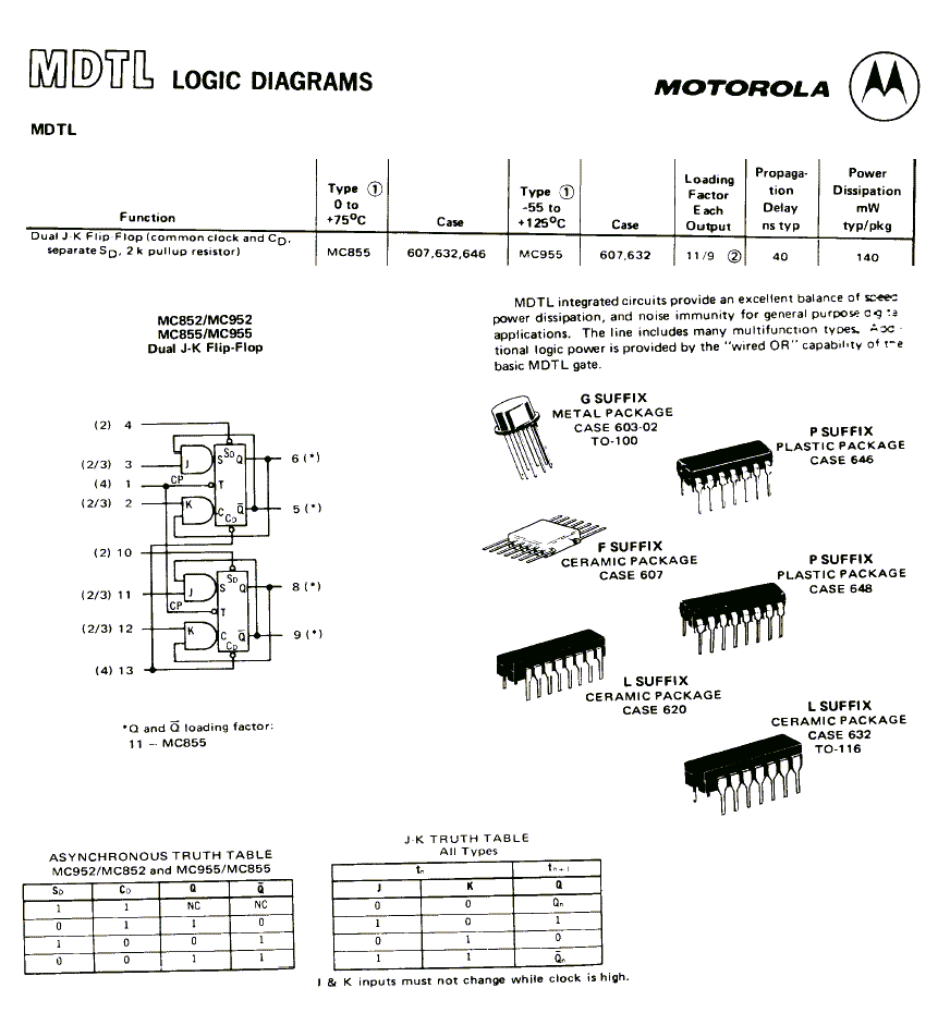

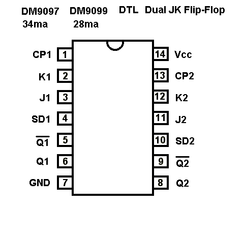

Here is the best I could do for now.
DM9097N Dual J-K Flip-Flop National Semiconductor
DM9097N=MC855P=NTE9097
MC855P Datasheet Included in this file.
  • motorola_mc_datasheet_1_.pdf
This is the info compiled from the Motorola Data on MC855P
